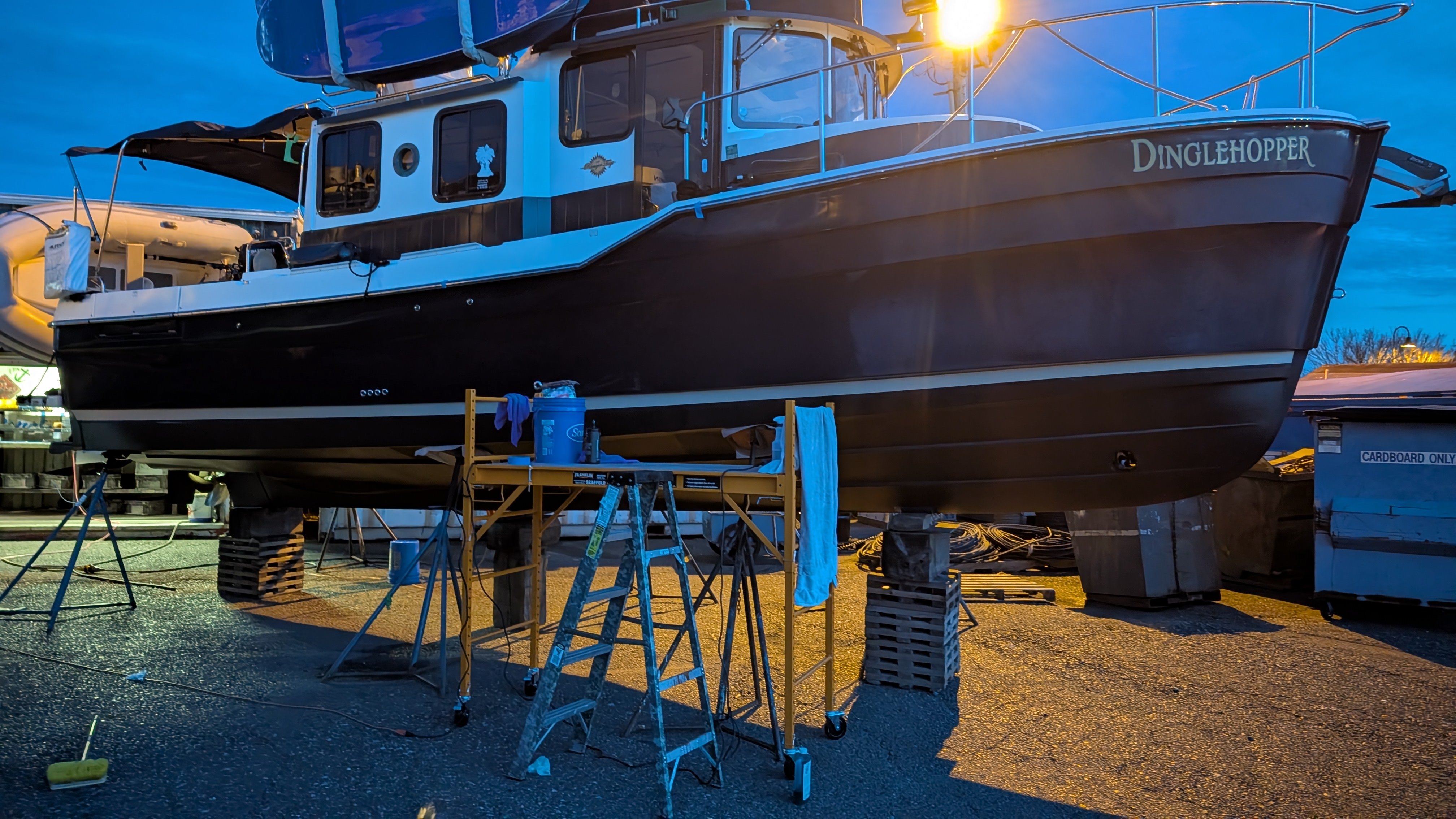

My motto is "progress over perfection", and so I was looking for something that was easy for a beginner, and wouldn't take dozens of hours of labor on my side. I landed on SKWOL products, and ordered their "protection" bundle that includes the #5 bottle of one step oxidation remover, and the #2 AF-S Marine Sealant along with pads and towels. I then went to harbor freight and bought their Hercules 6" forced random orbital polisher and their 900lb load yellow scaffolding.
My approach:
  • Get up on the scaffolding and sit....way easier than standing the whole time!

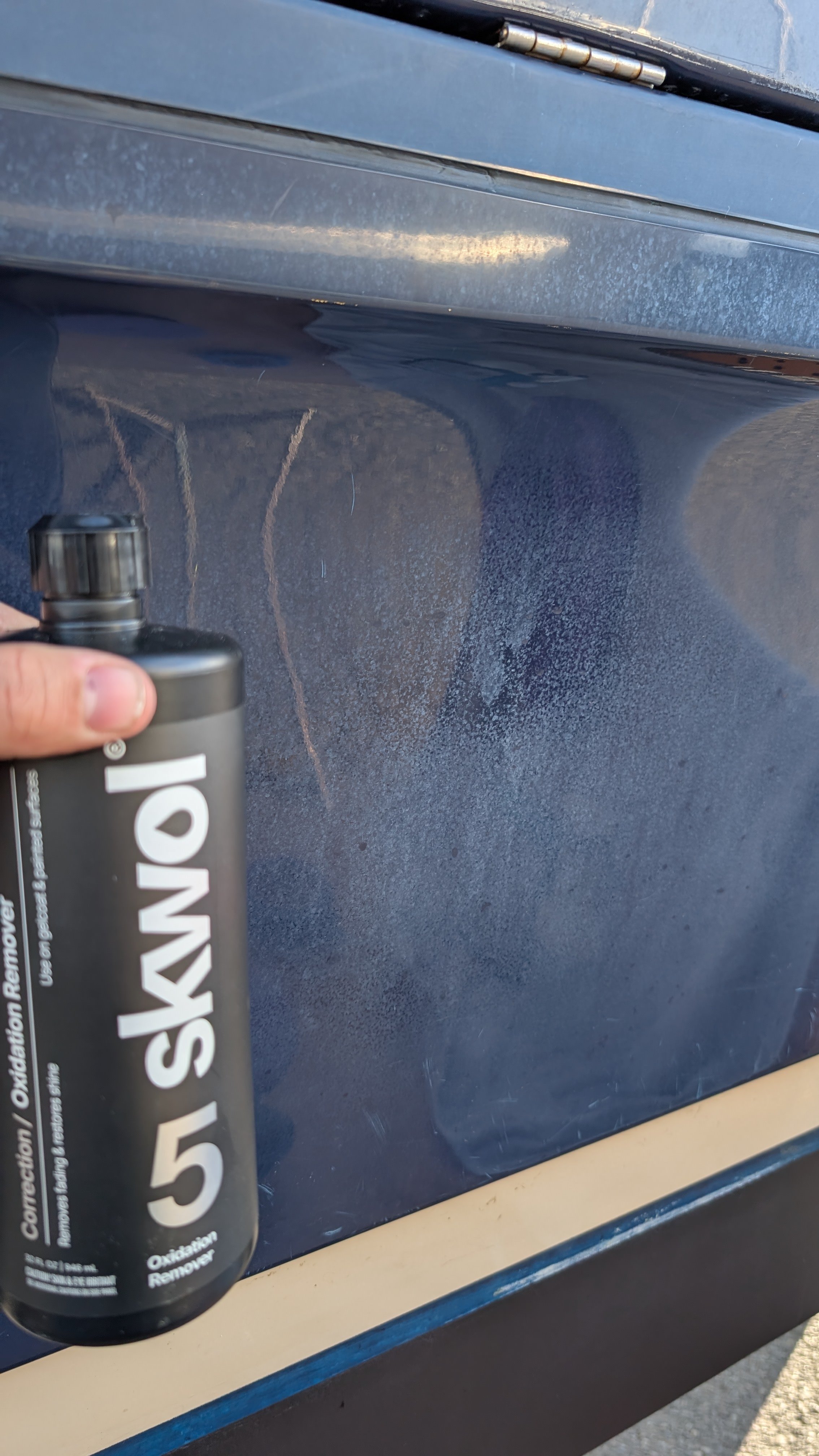

  • Load a circle of the #5 product to the pad, and blot it a few times on the hull
  • Spread the product across the target area at speed 1
  • Start applying pressure and do one vertical and one horizontal overlapping pass at speed 3
  • Bump up to speed 5 and do two vertical and two horizontal overlapping passes

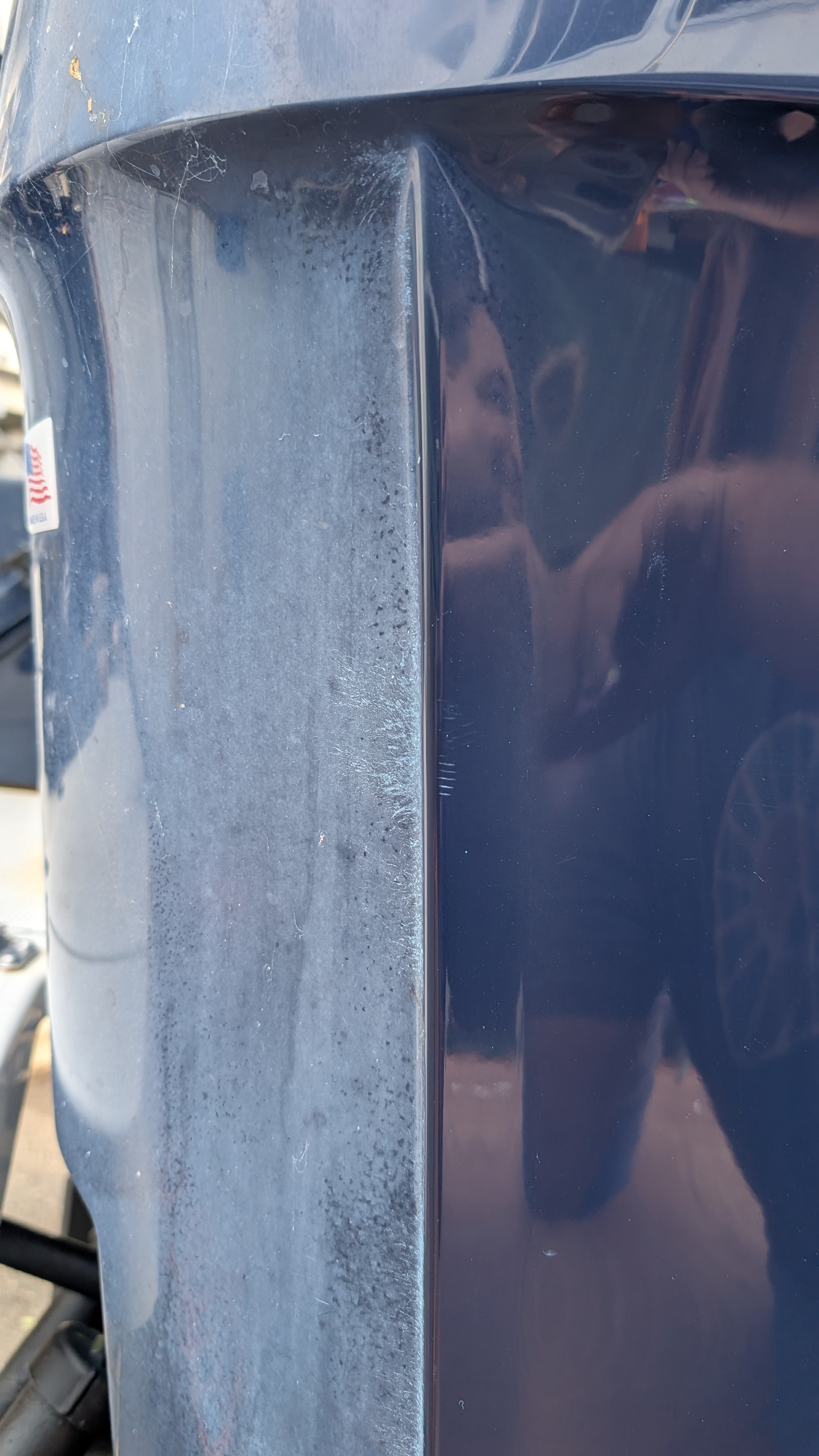

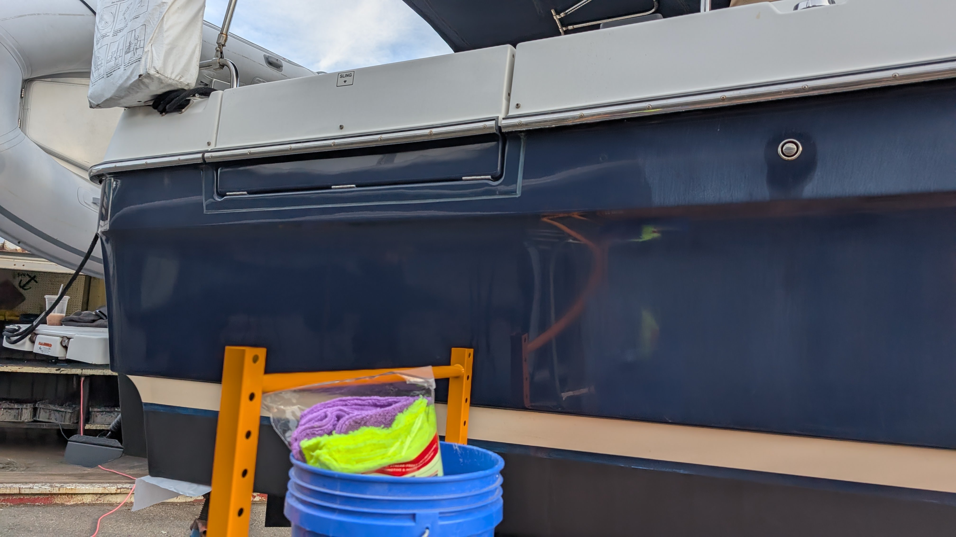

Results:

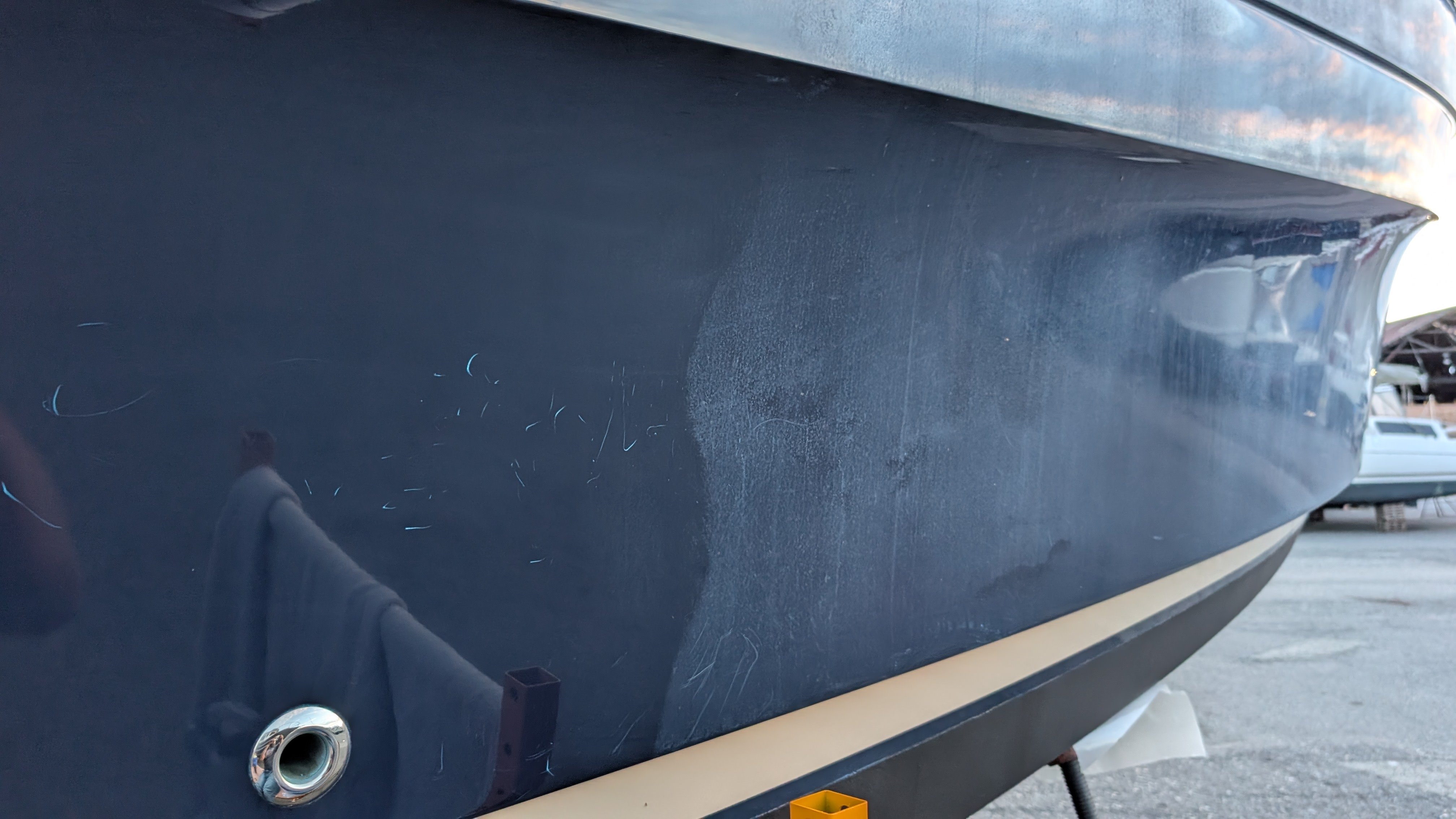

So far, I have been very impressed with the results. I would say a single pass made my hull 75% better and the second pass made it 90% better. As you can tell from the photos, my hull does have deep dings and scratches that no amount of buffing will take out as it has scratched very deep (you can feel how deep with your fingernail), but for the hull as a whole, the progress has been amazing.
I'm about 3 hours in and have made it nearly 1/3 of the way around. I'm hoping I can get it all complete in about 10ish hours. I'm encouraged by the fact that SKWOL does not contain any waxes or fillers, so I'm hoping the results I see are legitimate and not snake oil.
