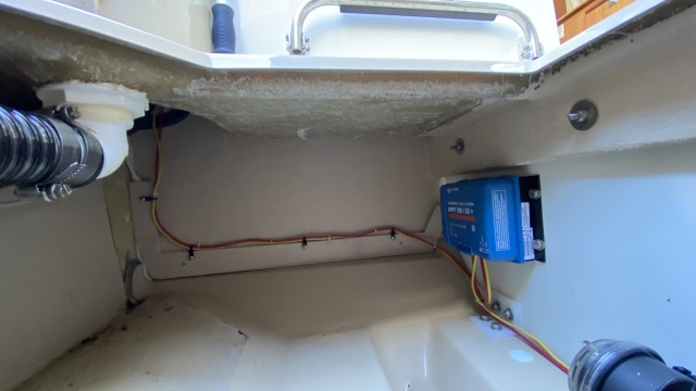

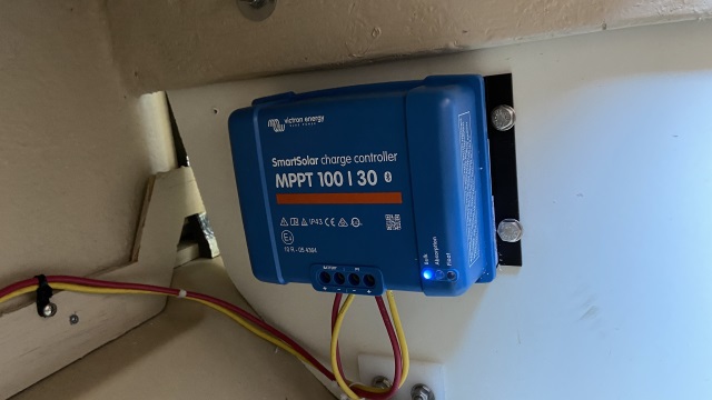

I can't quite tell from the pictures or if you located it somewhere else, but I believe you should have an inline fuse between the controller and the panel on the hot lead. HTH, Gary
