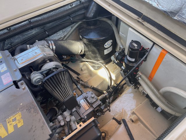

Here’s what may be your problem. These photos were taken to show the before and after orientation of the orange strap, but they just happened to capture when my boat’s shift cable shift cable was damaged by the technician. The boat was on its trailer inside a shop. I did not discover the damage until I attempted to launch the boat.
The photo below shows the shift cable BEFORE the technician laid it over. The cable enters the picture at upper left corner and runs down. See how it loops over runs almost vertically to the transmission shift lever.
This was taken the next day after the technician laid on the cable. It no longer is in a loop orientation; it runs at a 45° angle. One can see where it is crimped at the transmission.
This photo shows how the new shift cable was routed to minimize exposure to bending. It was run over on top of the holding tank and exits from on top of the holding tank next to the macerator pump behind the transmission. That keeps the cable’s open exposure to a minimum.
