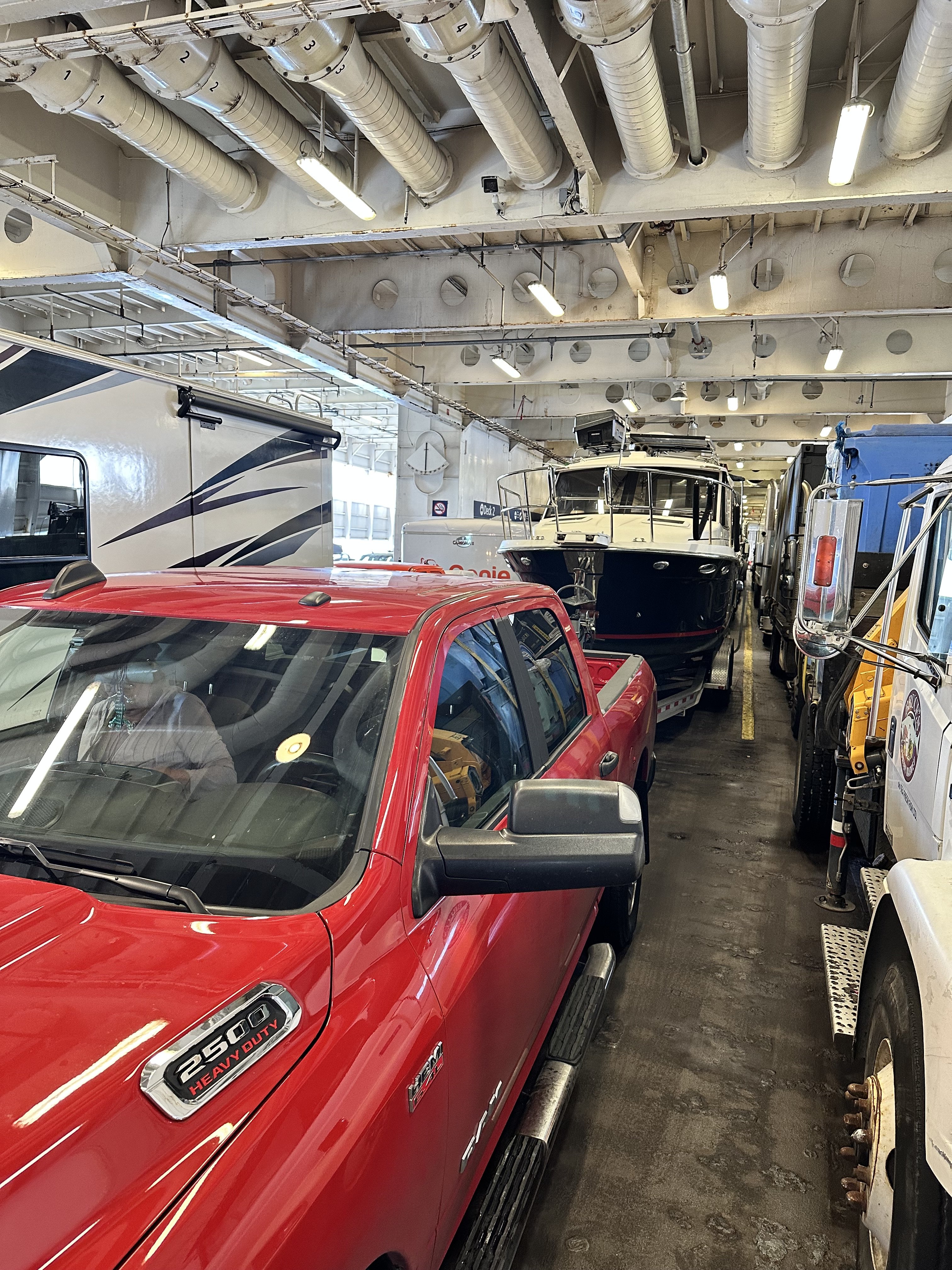

Towed our C-28 250 miles today from Port McNeill to Vancouver. Tomorrow it’s 595 miles of towing through Seattle, Tacoma and Portland to southern Oregon. The C-28 tows like a dream. Dinghy in p/u bed. We are just a smidgen under 7% gross towed weight of 12,600 pounds.
