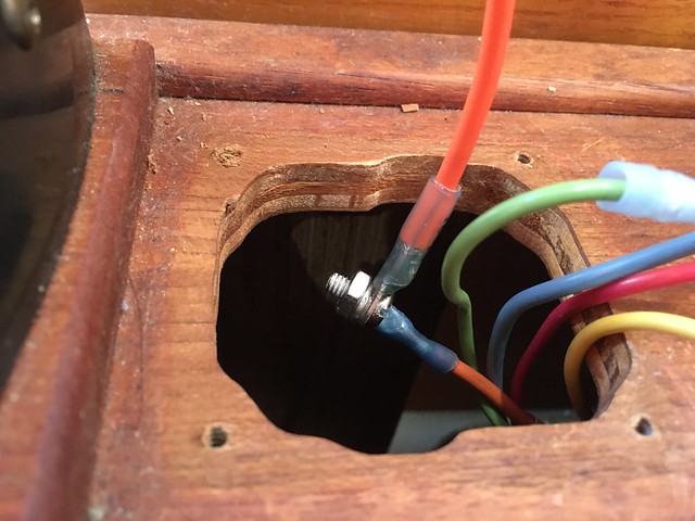

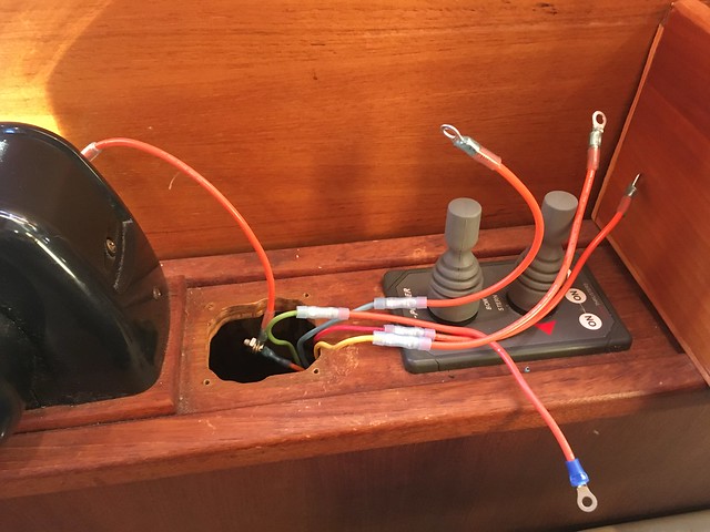

Here are a few pictures showing the extent of the problem. There was not enough slack in the wiring to even turn the switch so that I could unscrew the ring connectors from the terminals. So I cut the 4 signal wires and then was able (with a small angled screw driver) get access to unscrew the power lead. I then extended the wiring with but connecters (using the wiring provided with the switch). In order to save from re-terminating the power wire, I simply added a ring connector on one end and used a nut and bolt to fasten the two wires together. Switch is now installed and working properly. This seemed a much simpler method than removing the fridge... Access through the throttle housing would not have worked...
