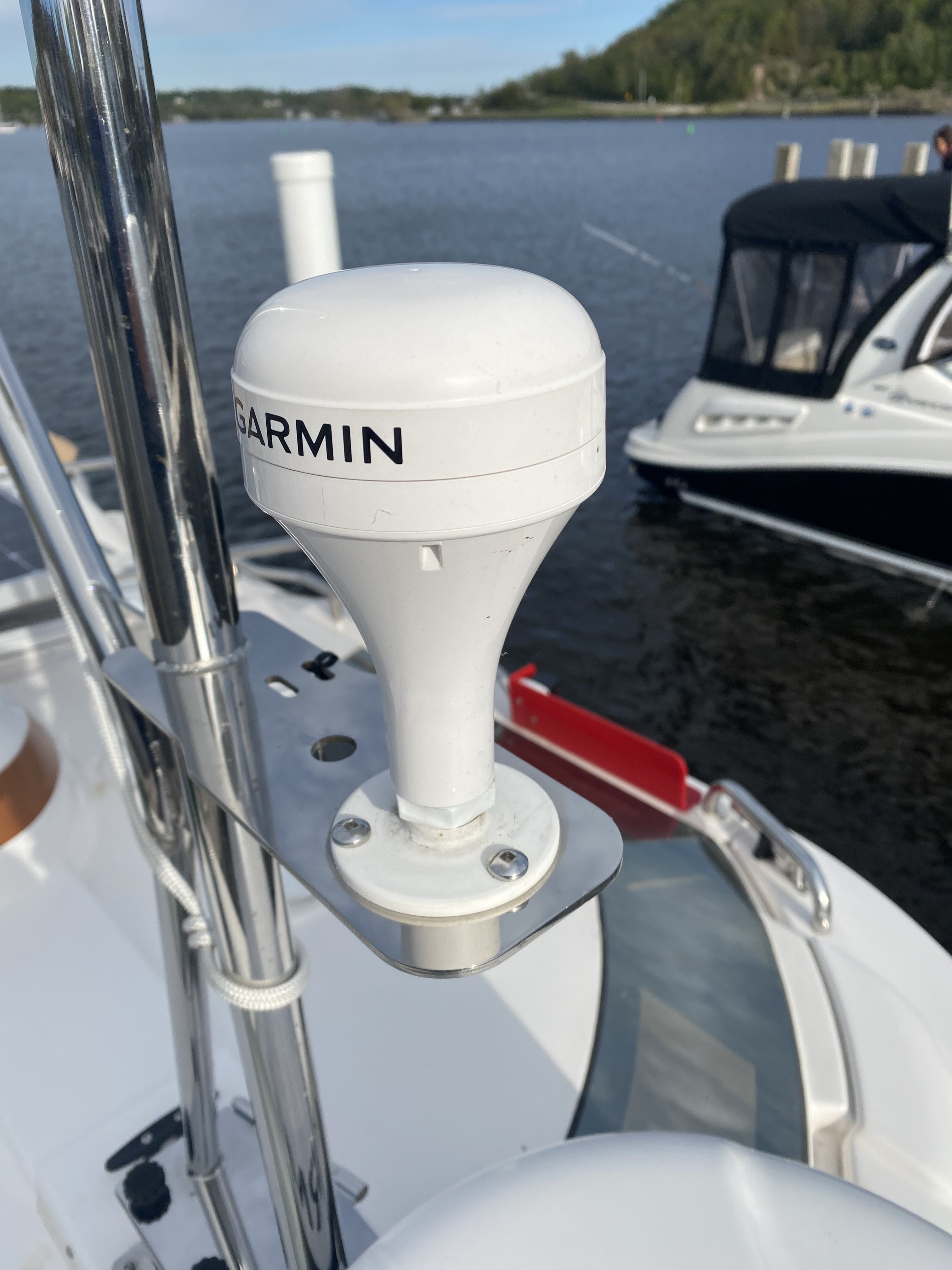

When I took delivery of my new to me R27OB it had the top half of theTV antenna sitting in the cabin.
https://majesticelectronics.us/tv-antennas/47-majestic-ufo-x-tv-antenna.html
I thought it would be a simple process to simply reattach it to its base, but I can’t find the base. According to the user manual the antenna is supposed to be on the forward part of the mast. There is a mounting plate there but that mount appears to hold a GPS antenna.
Any suggestions as to where the base plate may be?

The TV antenna attaches to a normal antenna base, which is what your GPS antenna is attached to. Remove the GPS antenna and that base is what the TV antenna sits on. However, the TV antenna also needs the VHF/UHF antenna cable in the mast to plug in to.

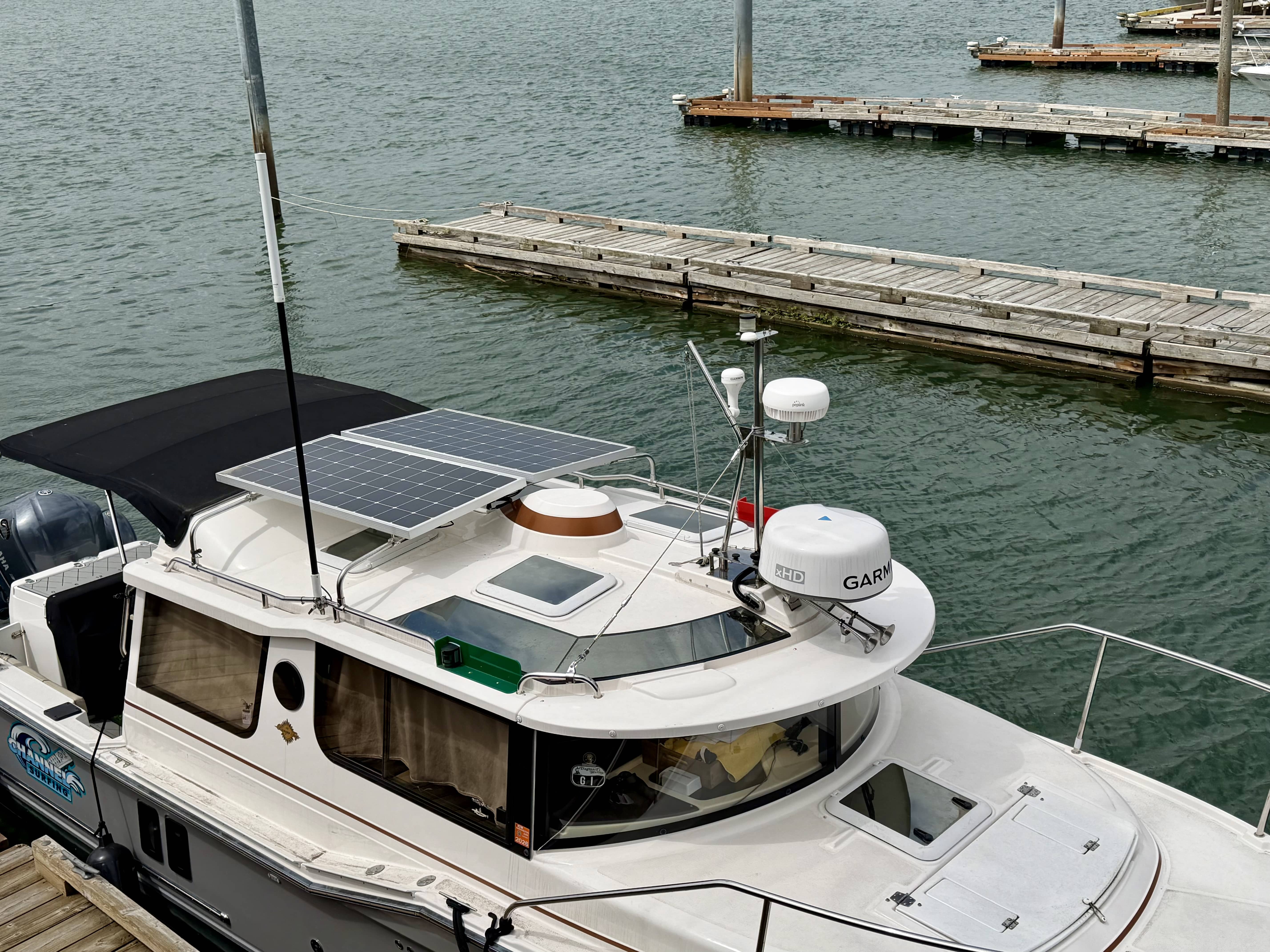

Hard saying what the previous owner did with the UHF/coax cable that plugs into the TV antenna. It may still be up on the mast, or they may have cut it.
What's the GPS antenna used for that's up on your mast? If it's for AIS, then if you remove it, your AIS won't function. It's not practical to swap out the GPS antenna for the TV antenna based on whether you're in port or not in my opinion.

AIS requires a dedicated GPS antenna for itself to function. That's probably what it's for on your boat.
