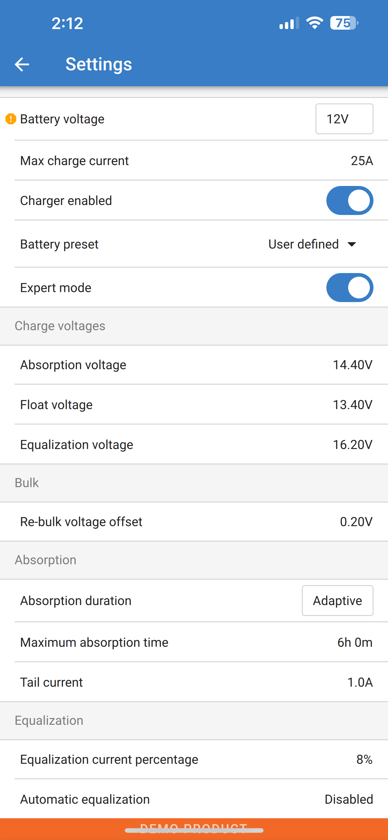

I just completed install on the MPPT 100/30 but am confused on what algorithm I should use for my UPG Universal house batteries.
Appreciate any advise provided.

It is my understanding that the Expert mode allows the user to set the parameters. Are the parameters you entered based on your house batteries? If so, did you contact the battery manufacturer and ask them for the specifics or is there a source to reference?

Here's the spec sheet on the UB121100 Universal AGM 110ah battieries. I still have 1 left onboard (my thruster battery). You could do 14.6 for absorption and 13.6 for float.
