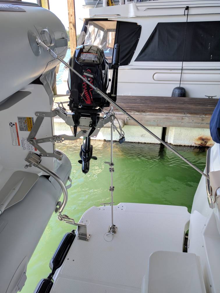

We haven't yet had the factory supplied dingy installed. I have balance problems. So even though the torqeedo is light and comes apart in three parts, I would like to mount the motor on a Weaver-Lever system that automatically attaches the motor to the dingy' transom as the dingy is lowered. The Weaver catalog notes that the rear davit or mounting bracket for dingy should be a special heavier one. Weaver, naturally, sells that at a extra charge. The motor only weighs 31 lbs. Does anyone have any experience with the Lever system? Or ideas? Thanks. Bob
We have the Weaver Leaver on our C30. We just tried it for the first time this week with a 60 lb motor. So far so good. I think the heavier bracket is needed. Attached is a link to photos and a short video. I forgot to get a video of moving the motor. Notice that one of the swim rails had to be removed.

I have had a Weaver Lever Davit system on my R31 for 4 years now and have liked it very much. It is really easy to use and keeps the outboard stored horizontally on the moveable transom lever.

Does the swim platform rails have to be removed to use a Weaver leaver?
One side of the swim rail needs to be removed. The motor is located where the rail used to be.
