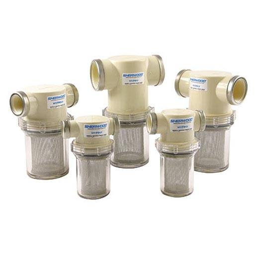

For owners with an R31 2022 (maybe earlier or later) how do you winterize the HAVC, washdown, and generator with the Sherwood strainers with a basket facing down?
