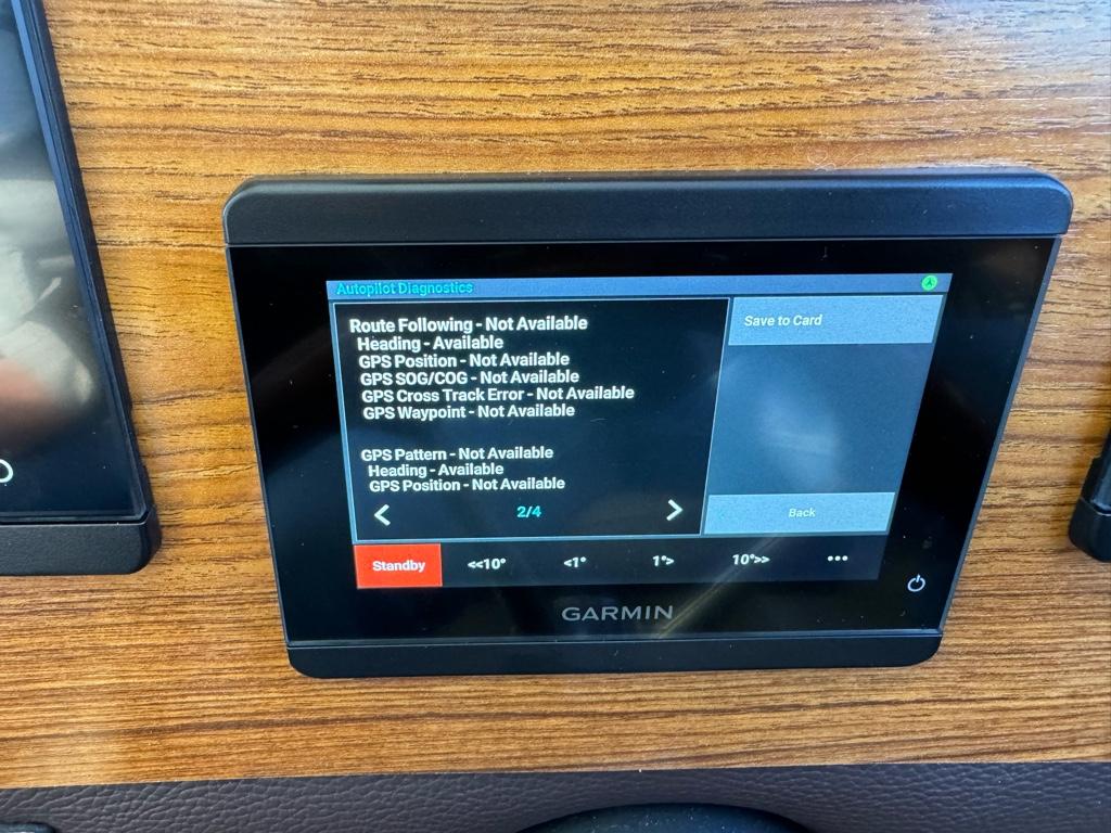

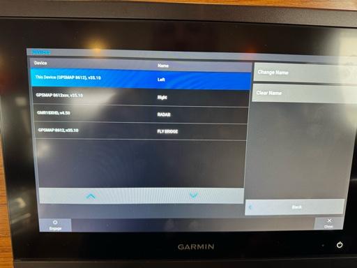

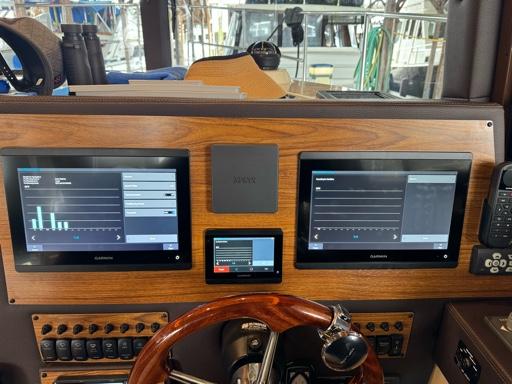

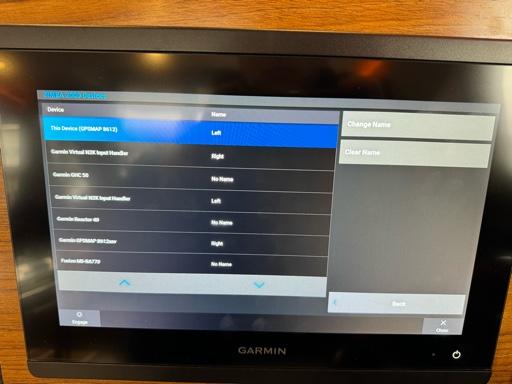

I finally got a Vesper Cortex installed but now I’ve hit some new problems. My autopilot is now not reporting GPS speed which also means auto guidance no longer works. I’m assuming the auto pilot feeds the Volvo engine display as well since that no longer displays speed. I can’t figure out how to select a source for the speed on the auto pilot or how to get the chart plotters to send the data. In the marine device list I can see the chart plotters and the cortex although the cortex doesn’t show as an active device. I know it’s working since I can get data through the cortex app. No idea what to do next.
