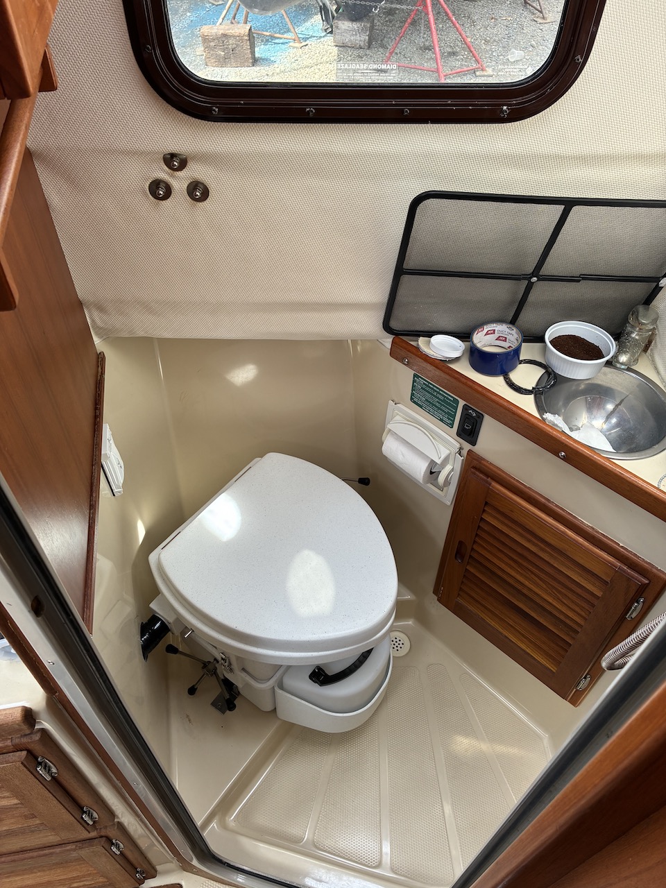

Natures Head. Used the left side vent (facing toilet) and ran it to a thru hull fitting above the water line. (I used the hole for the Wallis Stove vent since there was no Wallis Stove in the boat. I little time w/ the Dremel and a nice bronze 1-1/4" fitting worked nicely with the vent hose supplied with the head. It ran under the cabinet shelf in the adjacent cabinet, and i put an upward loop before the thru-hull to keep and splashed water out. Nice, clean setup. Where the holding tank was will become storage.
A few Pix of upgrades.

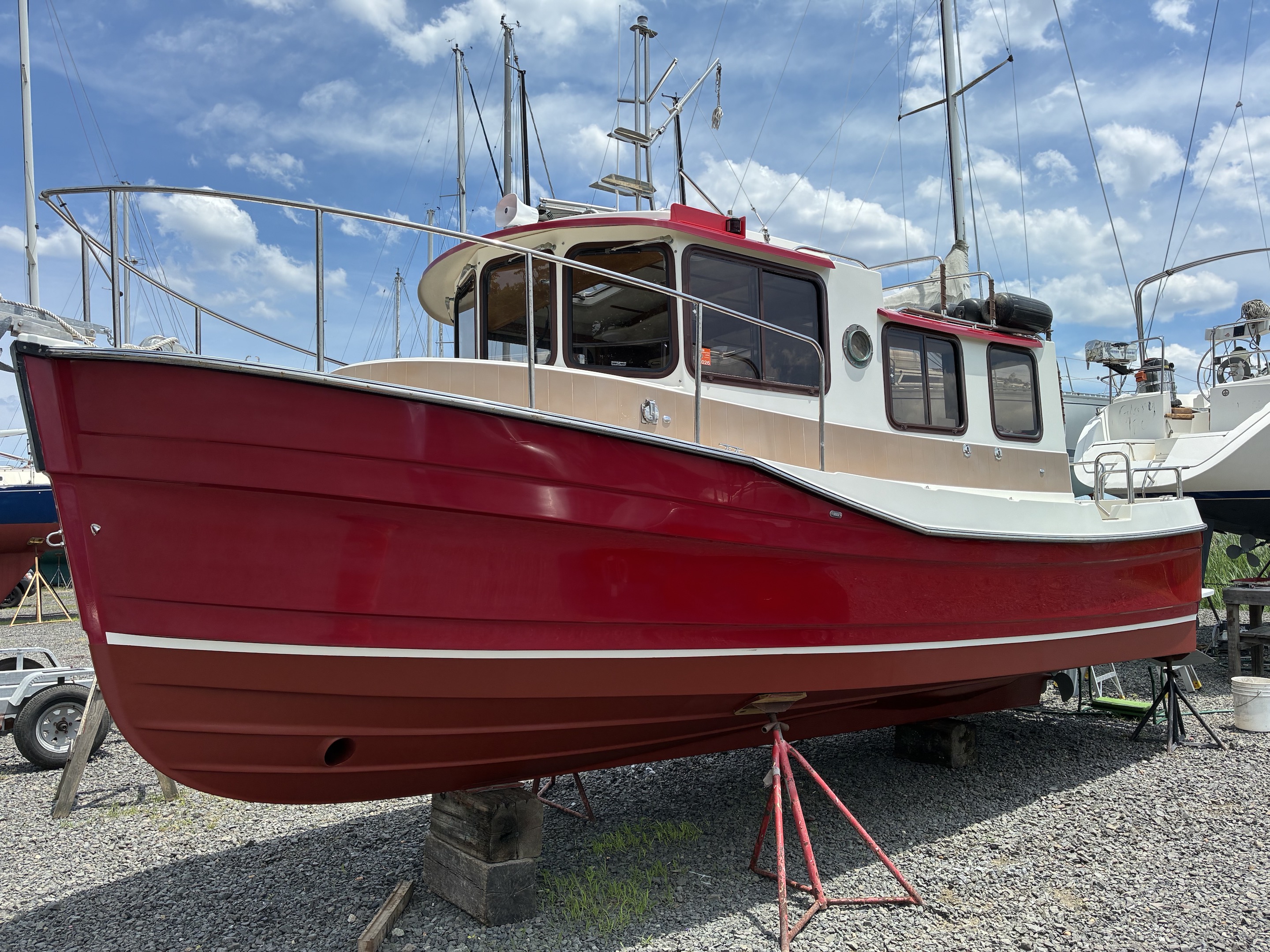

June 22 Updates on this vessel.
Sanded, compounded and waxed the hull and two coats of bottom paint. Bottom paint was in excellent condition. (Another curiosity given the neglect overall of the boat. Certain items were cared for. Most not.)
With a good light compounding and wax in autumn then again next spring, It might hold on to what it's got. The white is all fine, the red of course is a bad color for longevity. But as the picture shows- it came up pretty good for an 18 yr. old boat.

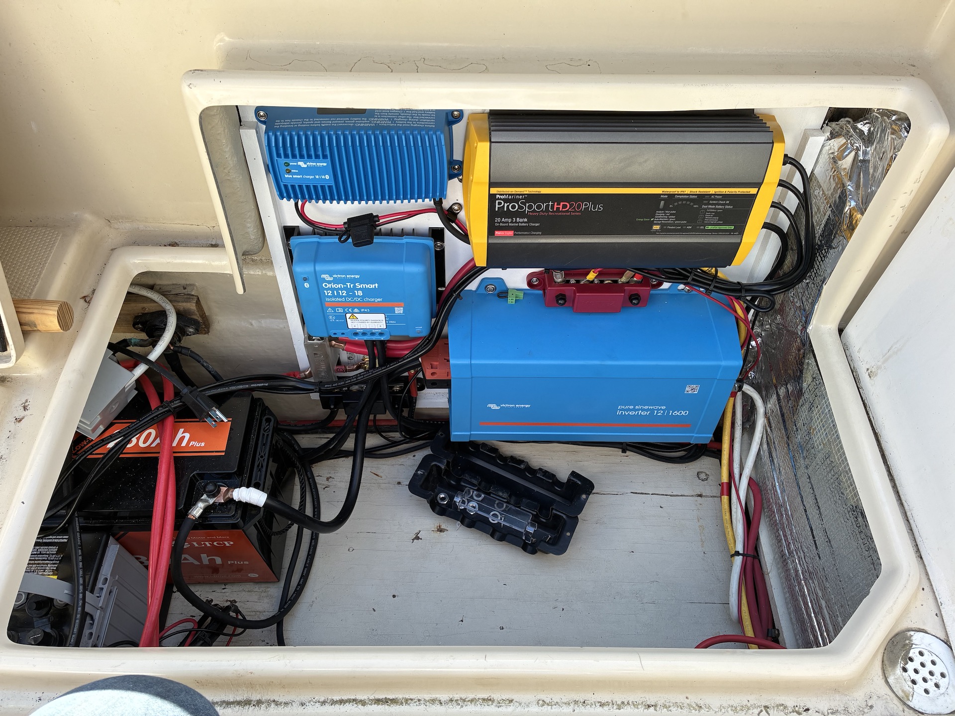

Head came out well, as did the new lithium power supply / inverter system. All works fine. Victron are the goods....

All told about a month of full time labor on my part. I only paid to have the local fiberglass guy do the hull sanding / compounding etc. A time thief of a job to be sure and it was with an abundance of caution due to the thinness of the remaining red gelcoat. Not cheap, but fair considering the man hours it took them.
All told about $60k in for what has become a nice example of a 2008 25 classic. There won't be a lot of margin if I were to sell her, maybe recoup minimum wage for my time at best, all the more reason to hold on to her and have some fun.

I gave the Inverter / charging setup install some thought before proceeding, but I found unless I try to get it wet on purpose, so far, so good. I will keep an eye out for the listing / water accumulation issue you mentioned.
