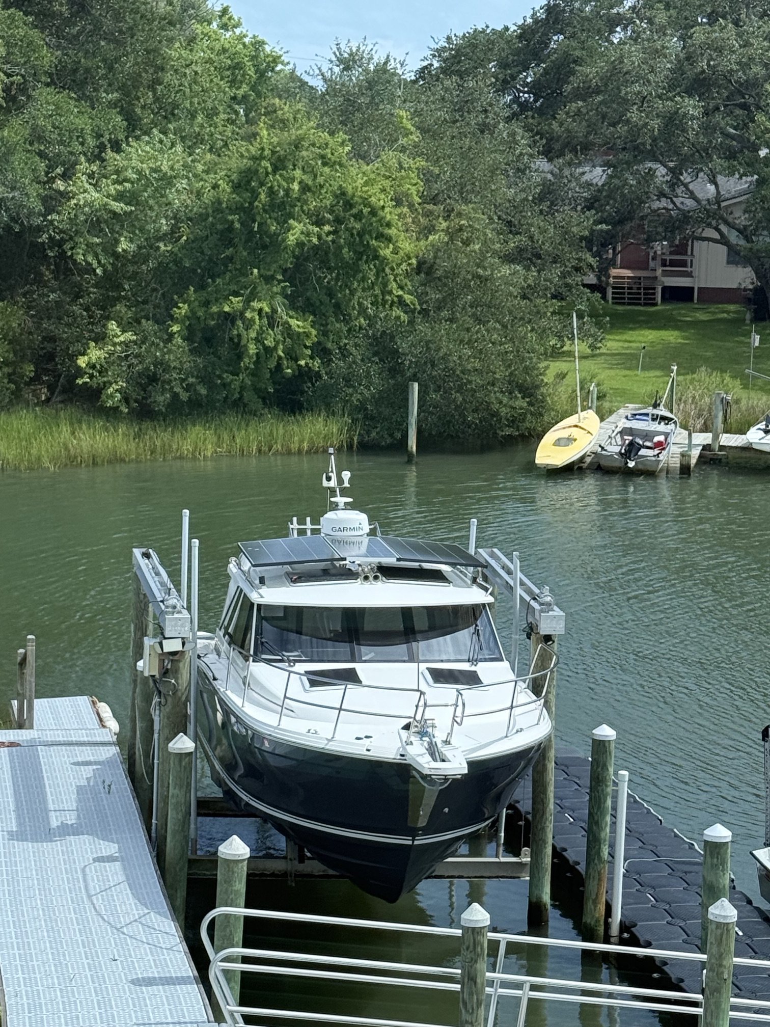

Finished the C-288 upgrade on 'Junie Bird'. Kept the factory 160W panel, added two Renogy 320W panels. The new panels have separate Victron 100/30 MPPT Smart controllers. One MPPT directly charges the Dakota 560Ah house bank, the other a new Eco-Worthy 314Ah Li battery. The new battery is isolated from the system with a Victron 12/12-80 Battery Diode combiner. Looking forward to more reliable power while on the hook...
