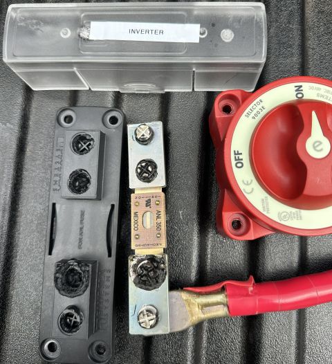

After a run on the boat last week, we were running the inverter while docked, doing our routine cleanup and running the AC and various other loads totaling around 180 amps. While I was flushing the drains and scuppers with the hatches open and I started to smell the familiar scent of burning wire, looking over at the port side hatch I saw a wiff of smoke. In a panic we shut everything down with fire extinguishers ready and I started feeling wires and visually tracking down where the smoke came from, which was the Inverter Fuse Block that had melted
After some troubleshooting, I determined that the 350A ANL Fuse for the Inverter was installed incorrectly, with the stainless washer in between the fuse and the buss. I won’t get into the technical details (unless someone wants), but in this configuration the stainless washer adds resistance, which is heat, which can lead to a fire.

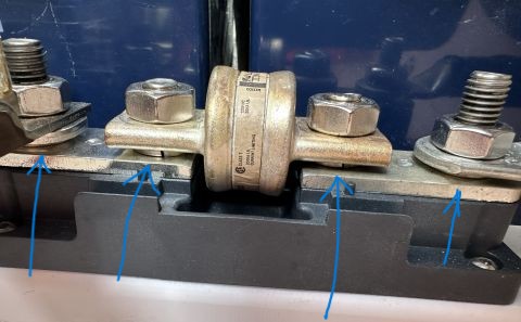

Upon further investigation, I noticed that the Main Fuse and connections to the Main Buss also had similar incorrect installations.

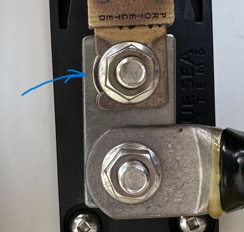

Just to confirm what I am assuming as I didn't see it specifically stated in your post. The stainless washer should be between the bolt and the fuse?
chromiumJust to confirm what I am assuming as I didn't see it specifically stated in your post. The stainless washer should be between the bolt and the fuse?
Yes. Stainless steel is not as good as a conductor due (in part) to the same oxide (Nickel and chromium oxide)that helps prevent corrosion. As the washer heats up more oxide is generated and this exasperates the problem causing more heat. Put the fuse directly into contact with the conductor bar and the washer under the nut.
