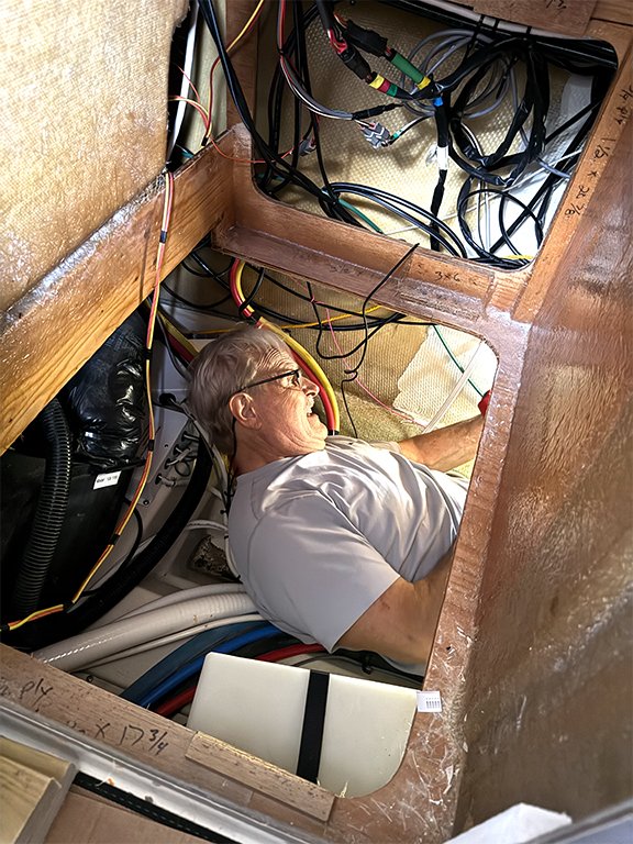

I have the same tug.
Lay down cardboard, Use 4 - 2''x6''s 30" or so long, unscrew the refrig. and pull it out resting on the 2x6s, then pull the cardboard out and towards the V-Berth. The transducer is right below the refrig. Be careful crawling in there, I had raw razor-sharp fiberglass and slit my arm. Once in the area the rest is sort of simple.
This is me in the refrigerator opening wiring for my backup camera nad additional solar panels. The tranducer is under my back.
