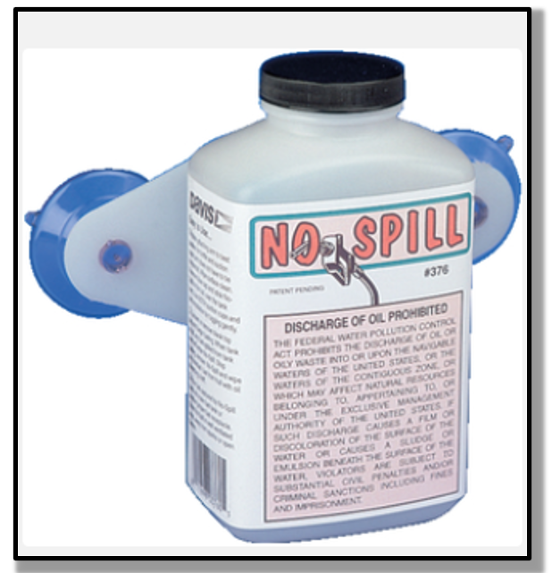

I took my fuel float out of tank to check it. There is two inches of air space left when float is maxed out. I have no idea how many gallons are in the 145 gallon tank when Garmin reads 100%. I was told by a Ranger Tug whiz that I should fill past 100% and stop when I hear the magic gurgle. Forget all that. The game changed when I got a "fuel catch" brand bottle. Or another brand is "no-spill". $45 on Amazon, and sometimes half that on eBay. I read how many gallons are left on Garmin, subtract that from 145 gal. Pump fast until near that and slow down until a little fuel flows into bottle. Bottle fits vent with two function cups. Add run-away string to bottle unless you want to pay another $45. Most expensive plastic bottle around yet worth it.

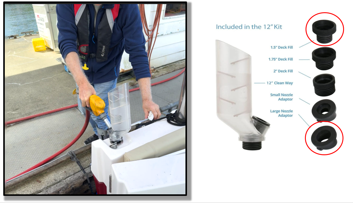

In addition, I use this device that is designed to capture overflow, but in fact we never get to that point. The real advantage of this is that it amplifies the sound of the fluid in the pipe and I find it much easier to detect the change in pitch when I get to the full tank level.
