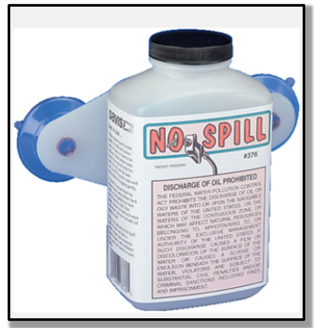

There are two fuel tanks on the R43, the aft one spits out quite a bit from the vent but the forward tank dribbles not at all. I think the forward tank has a longer distance from the tank to the vent and that might be the reason. Anyway, as Mastercraft mentioned, using a vent minder is what I do also. The suction cups stick better if you wet them first and also rub the salt off the hull before attaching.

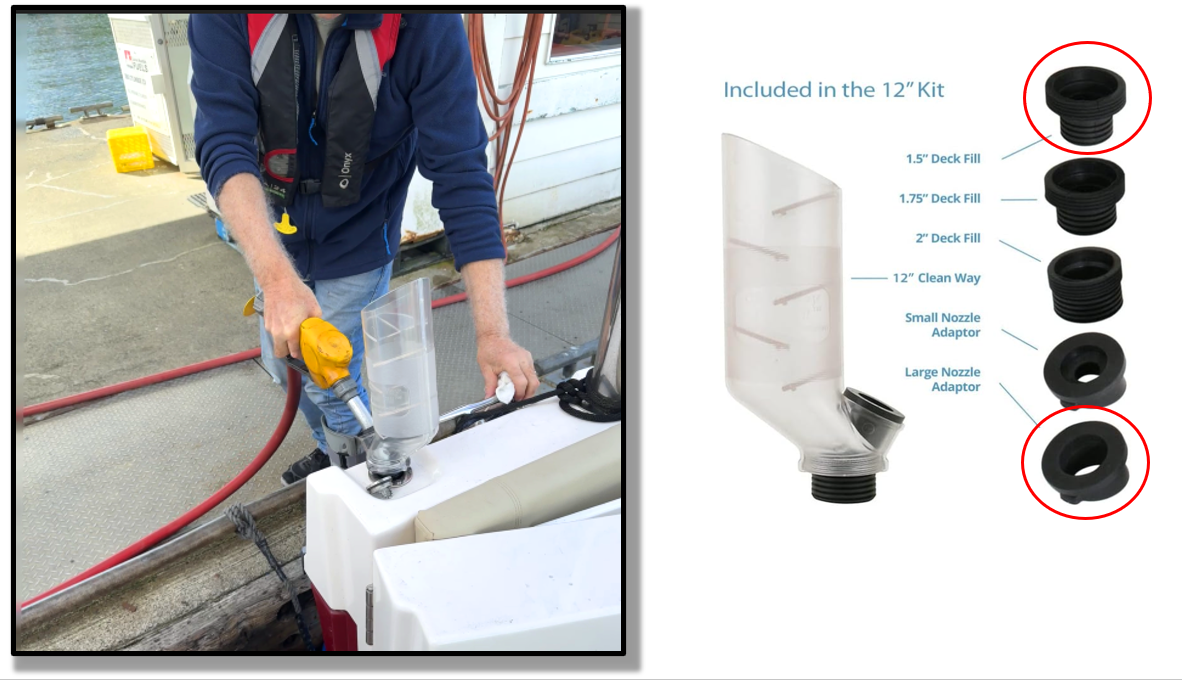

In addition, I use this device that is designed to capture overflow, but in fact we never get to that point. The real advantage of this is that it amplifies the sound of the fluid in the pipe and I find it much easier to detect the change in pitch when I get to the full tank level.
