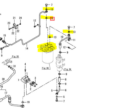

Thought I would pass along what I've discovered with my 6BY2-260 Yanmar engine fuel leak. Back in March I was doing my fuel filter changes. The engine mounted spin on filter was leaking at the mating surface with the manifold (called a filter head). What I discovered was corrosion on the mating surface of the manifold. The corrosion caused he paint to lift and give me an uneven mating surface. I was cruising in FL at the time I was able to use a combination of razor blades and emory paper to get as smooth of a surface as possible. No leaks after really torquing to filter tight. My plan was to replace the filter head at the next fuel filter change but after taking the boat out today, I smelled, then found a leak at the filter mating surface. A new manifold will cost about $500. Ugh. luckily, it appears to be an easy fix with a couple of banjo bolts on top and mounting bolts into the block.
I remember a few years ago another tug with the same problem on a 4BY2 180. When I change my filters I use a mirror to look up at the mating surface and make sure it’s clean. You may need to replace #13 when you remove the Banjo bolts. While you have that off check the clamps on the fuel pump (#34), they are known to fail. Good luck with the repair.
I’ve got 4 washers (#13) coming as well. Thanks for the heads up on the pump.

Bob, sorry for putting a curve in the thread. Your post was awesome with the illustration and explanation .
Brian's point is well taken. However, the bad filter I had was supposedly OEM. With that said, I use several sources for parts. Some from a Yanmar dealer some on e-bay. It could be possible that the e-bay product is a knockoff and you have no way of telling. The other day I received an oil filter ordered from e-bay in a yanmar box. The price was good and the yanmar o-ring was in the box, but it was a Mann filter. Buyer beware.
It looks like the filter head is a removable part in the diagram. If it in fact needs replacing, the mating surface to the filter quite possibly could be fly cut by a local machinist or possibly honed by you to restore the mating surface rather than replacing it. Something to consider before spending 500.
