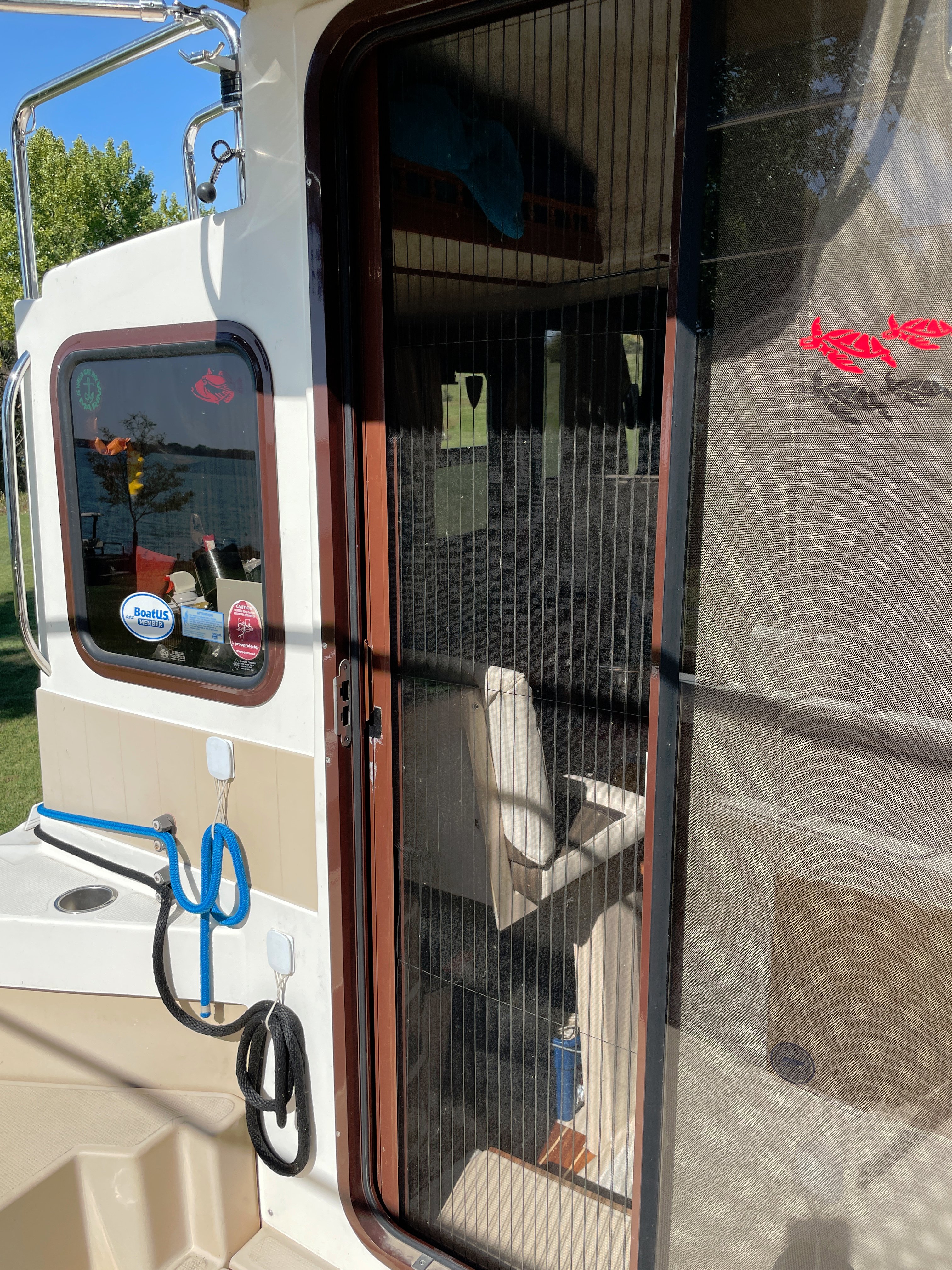

We do not go to the bow for docking. We only go to the bow when retrieving the anchor. For docking, we have lead lines from the bow (blue) and the mid-ship cleat (black) to the cockpit where they are lead to cam cleats and stored on "button line hangers." When docking, the mate passes one or both lines to folks on the dock or steps off the boat with lines in hand. That way the mate stays safely in the cockpit and can handle the stern line (red) also. We did the Loop with this arrangement and never had any issues. The photo shows the port-side line arrangement. Starboard side is similar. This also allows the Captain to easily tell the mate which line to pass by color - not all mates are equally sea-worthy and the color coding mostly eliminates confusion. Note also the screen door, which is probably the best thing we have added to the tug.
Wow, good idea!
