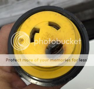

It is fine... until it isn't...
That's what it looks like when you have a problem. We always used the screw on retainer ring; followed proper procedures for plugging in the cord. It also burned the first couple of inches of wiring into the boat - I replaced that entire section of wire, also.
I didn't think there was a problem with the Marinco, but I looked at it every time before plugging it in. I never felt Smart Plug was trying to scare me into making the change. I saw another boaters cord that looked much worse than mine... that concerned me. I said to myself, "If that ever happens to mine, I will replace it with the Smart Plug." A week later, we had the problem.

The whale watch office where we worked last summer was right next door to Friday Harbor Marine - I saw the regular flow of people going in there to replace their fried Marinco connection. Enough so that my wife wondered aloud if there was a problem with the wiring at the Friday Harbor docks. I can't say; never a problem with the reverse polarity indicator on our electrical panel. No indication that there was a problem until I saw the fried connection.
My advice: take a moment to check that cord end every time you plug in or unplug.

I have seen a few plugs that looked like the one pictured above and when I inquired with the owners I found that several people were connecting the plug to the boat with a load on the circuit. That is they did not take the time to turn the shore power switch to the off position, on the boat. A cord should never be used as a switch. There should be no load on the circuit when connecting the cord or arching will occur because you are making the connection slowly. Make all the connections, then turn the shore breaker or power selector switch to the on position.
