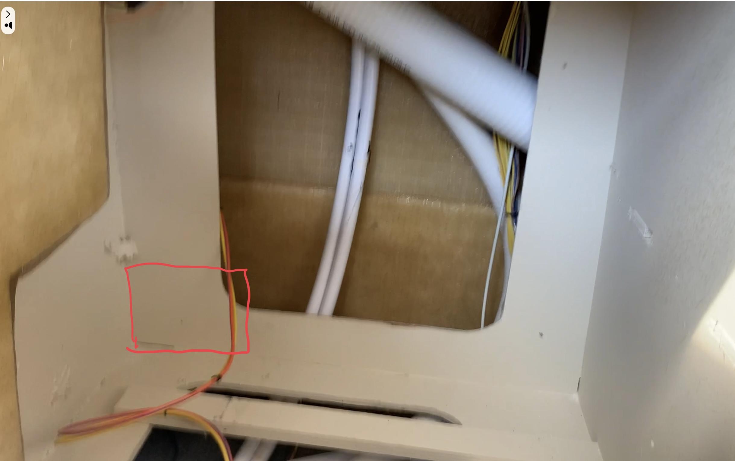

After reading Submariner's posts and asking him a few questions, I purchased and installed the Lenco Autoglide on our 2021 R25 OB. Took the boat out today and calibrated, and wow - what a difference! As advertised, the boat gets up on plane quicker, the ride is smoother, and observed fuel consumption dropped at normal cruising speed. Install is fairly straight forward/plug and play (with some helpful advice from Submariner). One difference between the R27 and R25 installs, is that on the R25, you have to take out the refrigerator to get access to the Lenco keypad and wiring. A very worthwhile upgrade in my opinion.
Hi - We have a 2023 R25OB - wondering where you mounted the control box. Behind the fridge? Did you need to use the Control Box Mounting Bracket (SKU:LEN-70568-001). Thanks so much.
sparlato":1anv7hol said:
Kevin, from Premier Custom Ceramic Coating, has a r25-OB and installed Autoglide with the bracket behind the refrigerator.
Sent from my iPhone using Tapatalk Pro
I installed mine here on our R-23 (similar helm seat/fridge configuration. No bracket needed.

Thanks so much! We are out of Port of Edmonds. Will give it a try behind the fridge with bracket. If I run into any trouble I might need a few pointers. Thanks again.
Thank you. I’ll send you a personal message later today.
