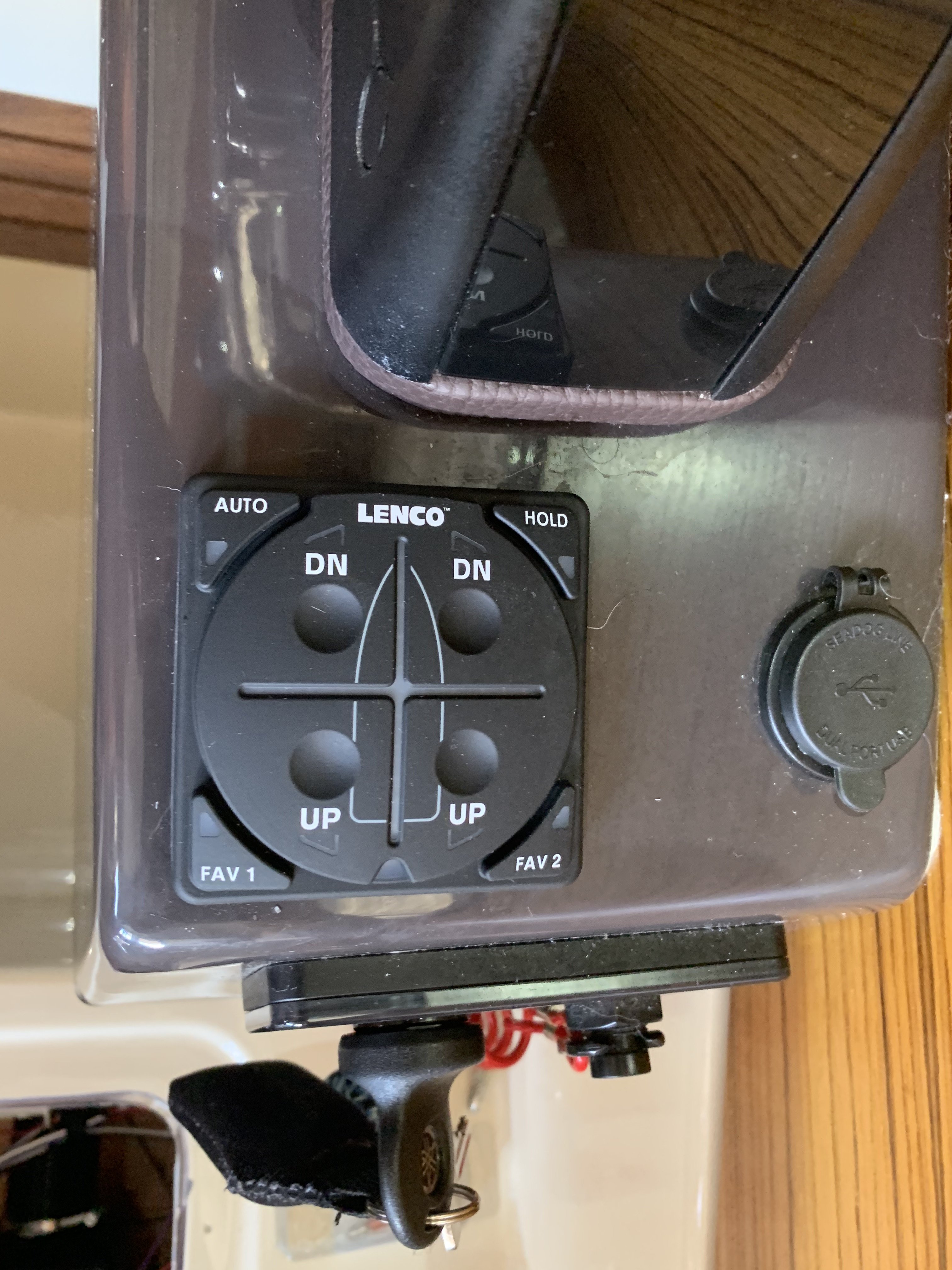

Martin just upgraded my R25-OB, he knows what he's doing 😀
Still getting use to my Autoglide, but glad we did it.

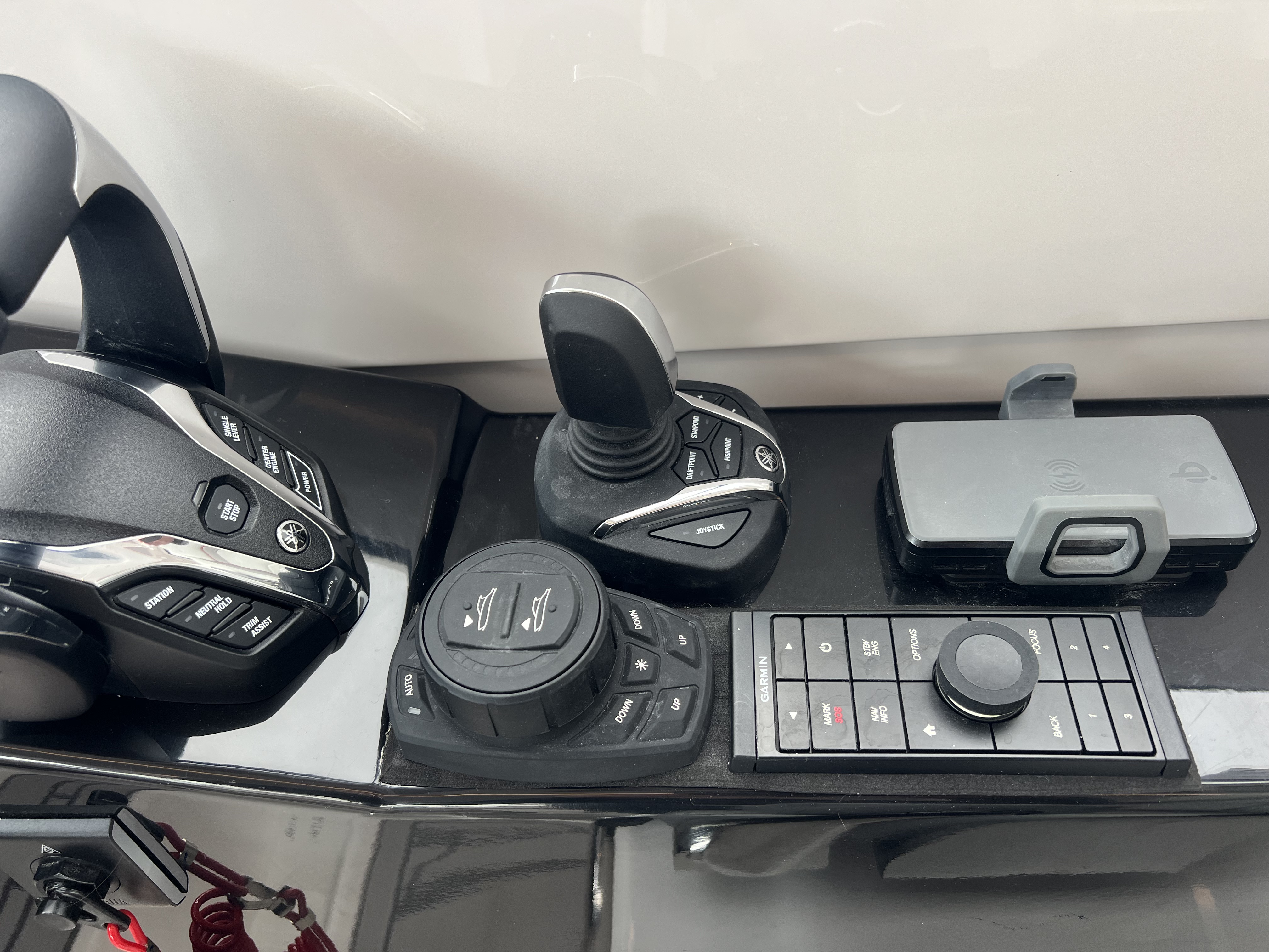

Lenco has officially deprecated/discontinued the Autoglide. Their new and improved Pro Control, requires new trim tabs, new actuators and the switch won't fit on my helm (not enough space) as the new Pro Control switch is physically larger than the Autoglide switch.
It really does seem like a step backward.
I contacted Lenco asking that they reconsider their decision to discontinue the Lenco Autoglide. There doesn't appear to be a technological reason why they discontinued it, other than they came out with a "new and improved" version and would rather customers bought that.
The Lenco Autoglide is a drop-in upgrade to their standard trim tabs and 100 series actuators, which is standard on our boats. Their new Pro Control requires their XD actuators and different tabs that move faster than the 100 series actuators. It appears to me that they're trying to compete with the SeaKeeper Ride system. If you can move the tabs faster, in theory, you can take out some of the chop in choppy waters. Personally, that's not a problem I need solved. In the Pacific Northwest, when it gets choppy, I slow the boat down to 11-15mph and it makes the ride more enjoyable.
The biggest issue with the Pro Control is they redesigned the switch to be a rectangle. It fits the same hole as the Autoglide and manual switch controls. But the Autoglide is the same size (square) as the manual switch. The Pro Control, being a rectangle, is physically larger. So large, there just isn't any place on my helm to put it. Lenco insisted that the Pro Control switch was backwards compatible and would fit in the same hole as the Autoglide. I sent photos to Lenco to illustrate. Their response was, and I'm paraphrasing... "...it's a shame the Yamaha binnacle wasn't installed a few inches forward..." I could replace my actuators and tabs, but the Pro Control switch doesn't have a place it'll fit on my boat. Lenco also expressed to me that they're not interested in bringing back the Autoglide. This is disappointing to hear as Autoglide does what it's supposed to do, and in the waters I travel, it's fantastic. One of the best upgrades I've made to Channel Surfing.
The Seakeeper ride switch controls, as well as Bennet AutoPro (similar to the Autoglide), both would work on my boat and would fit the helm. Zipwake would not fit my helm.
If I upgraded to a Solara S-310 Sport Bridge, the Lenco Pro Control would fit and function. 😀
View attachment 25541View attachment 25542
