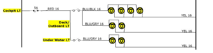

Yes, the switches just pull straight out. There is nothing holding them in except a tight fit into the cutout. You'll find the underwater lights and the exterior courtesy lights are wired together and run back to a single 5amp fuse in the house fuse bank behind the helm. In my opinion wiring these together is a problem. I replaced the switches and redid the wiring on my 2024 R25 so that the underwater lights run to their own dedicated fuse. Since I also replaced the underwater lights with more powerful Lumitec lights, I used a larger fuse and higher gauge of wire.

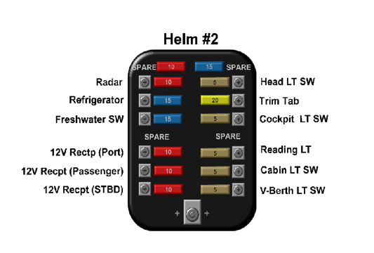

Agreed! this is so helpful @JMarshallR25 @Adam youll have to let me know how the fix goes for you. I noticed when I pulled my switches out of the fiberglass that the connector to one of them was still on the back of the switch, but the wire had pulled out of it. So now I've purchased a new wire connector kit and i just purchased two new switches. Ill have to carefully cut and strip the wire and put the new connector on it. None of the fuses on my fuse directory sheet say "outdoor lighting" is there something else ranger tug would call them? I just went through a massive project replacing my lenco autoglide trim tabs with a manual control after I had some weird electrical short in the autoglide system (removing fridge, a ton of wiring, etc) so now this project feels very manageable in comparison to that mess, but I still dont know if my issue is the lights themselves, the fuse, the switches, or the wiring but ill just go step by step until its solved. Also my boat lives in salt water in a slip in Seattle, so I dont think I can access the underwater lights until I pull it for service later this winter. Or is there a way to access them while its in the water? Thanks again!

The fuse is the one labeled "cockpit lt." Look how many lights are wired to this one 5 amp fuse. The Hella courtesy lights are very low draw, but I suspect the underwater lights draw an amp or two each.

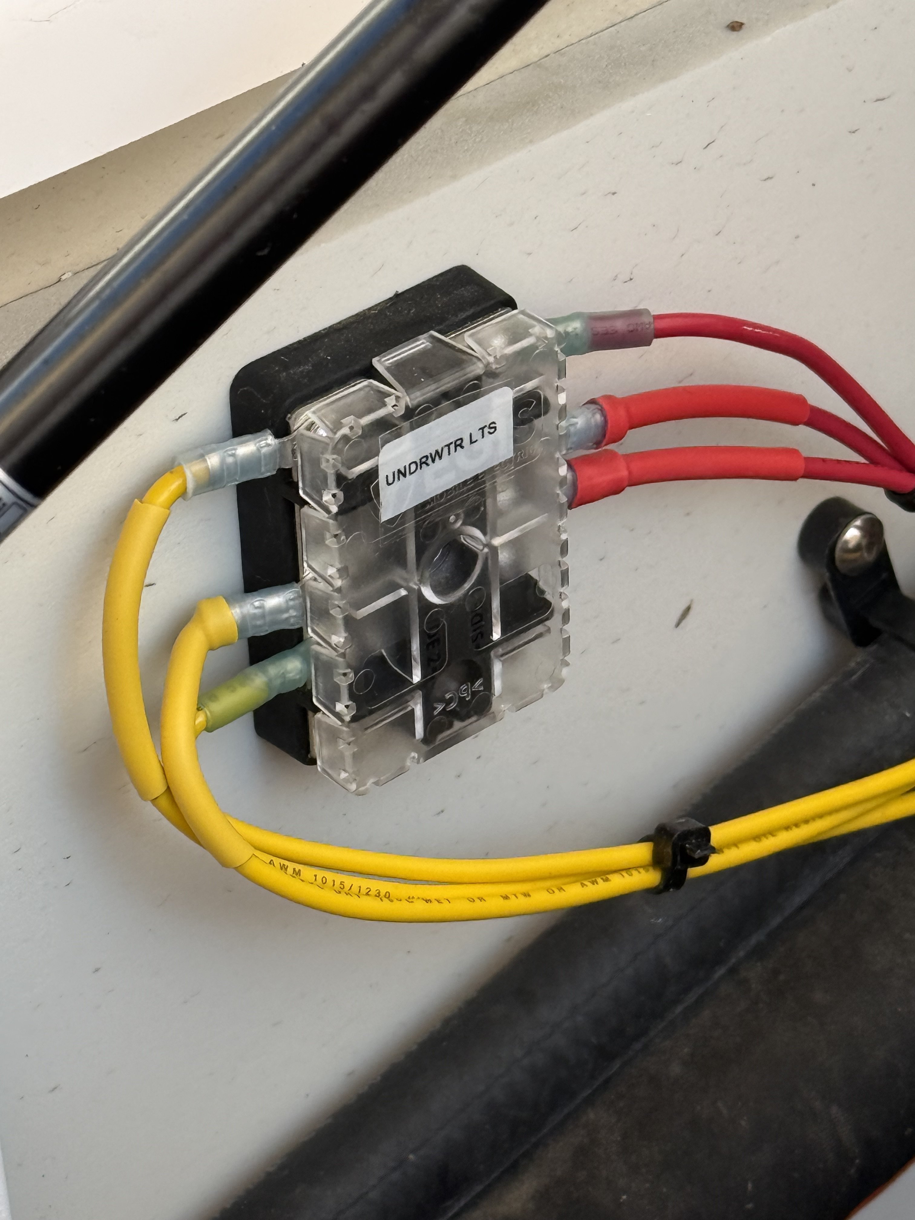

I rewired the underwater lights because I added larger Lumitec lights that draw more power. Everything was fairly accessible. I have the underwater lights completely separate from the courtesy lights now. The courtesy lights are still on the 5A fuse in the helm fuse block. I’ll send a picture later.
Here is the new underwater light wiring on the starboard side of the center lazarette. They are completely isolated from the courtesy lights. I have power running from the 24/7 fuse block to the cockpit switch. The power then runs to this bus bar and then to the lights. There’s a 3d printed tab on the switch itself to prevent the lights accidentally being left on and draining the battery. (This would be a concern, even if the underwater lights were still powered by the house bank, because I leave house power on 24/7 to keep the fridge cold. The solar panel keeps up with the fridge, but could not keep up with the fridge plus the underwater lights).
