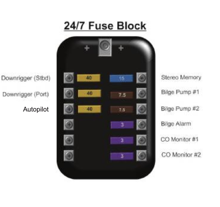

From the R-23 manual. The bilge pump is in the 24/7 fuse panel.
The 24/7 fuse block is
located in the mid cabin behind a removable panel secured with Velcro
It’s, fused, but no breaker. I have a different pump but same set up. Bypasses the battery switch. Always has power, as long as the batteries aren’t dead.
