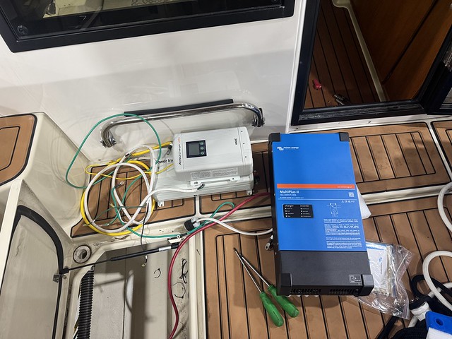

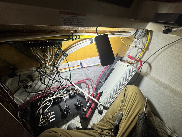

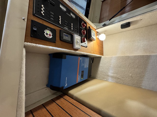

Spent the first day with the r23 doing phase one of our electrical overhaul
Waiting on my lithium batteries to come in, so decided to tackle, arguably, the most labor intensive portion. Change out the inverter and battery charger to an inverter/charger and starting and thruster charger
I used a Victron multiplus 3000kva 2, and an ip22 charger with three outputs.
Had to disassemble the whole power area. I did cut it in two pieces to make servicability easier. Put a metal flange on it so when it's all screwed back in it lines up nice.

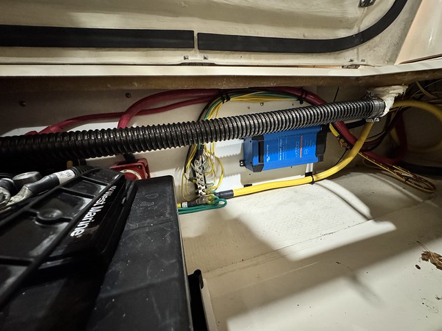

Went from shore power to elci, elci to ac in on the inverter, ac out 1 from the inverter to the old shore power in (moved labels around), and then that powers the panel as if on shore power. Ac out 2 which only works on shore power, is dedicated to the battery chargers for starter and thruster and automatically engage about a minute after shore power
Upgraded all inverter wiring to 4/0 as well and will retrofit the system as I make other changes.
Inverter/charger are currently derated so not to overload existing bottlenecks in the wire.

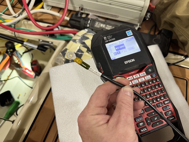

Always make sure you label every new wire that goes in!

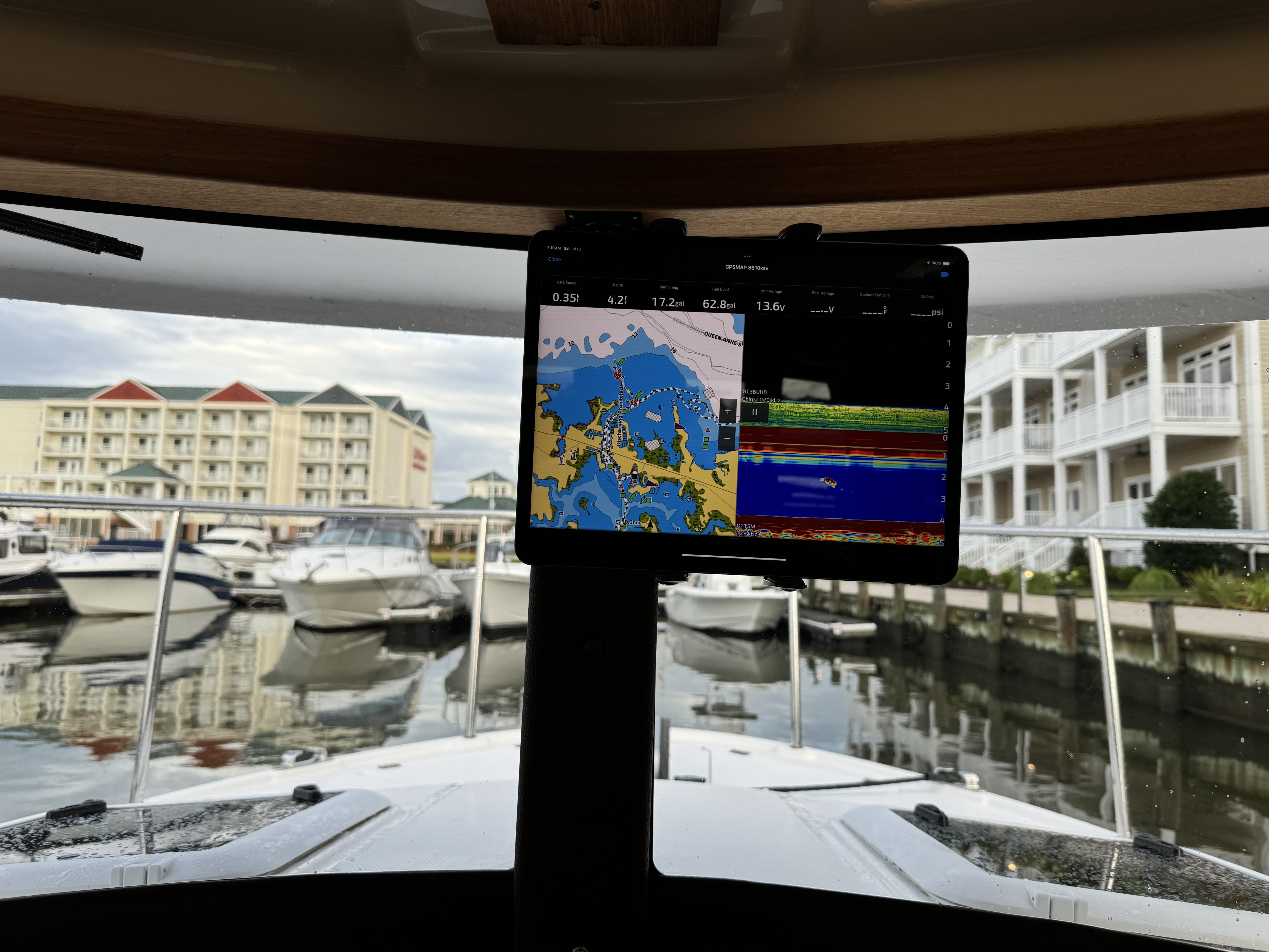

looks like you are off to a good start. Where did you mount your touch screen?

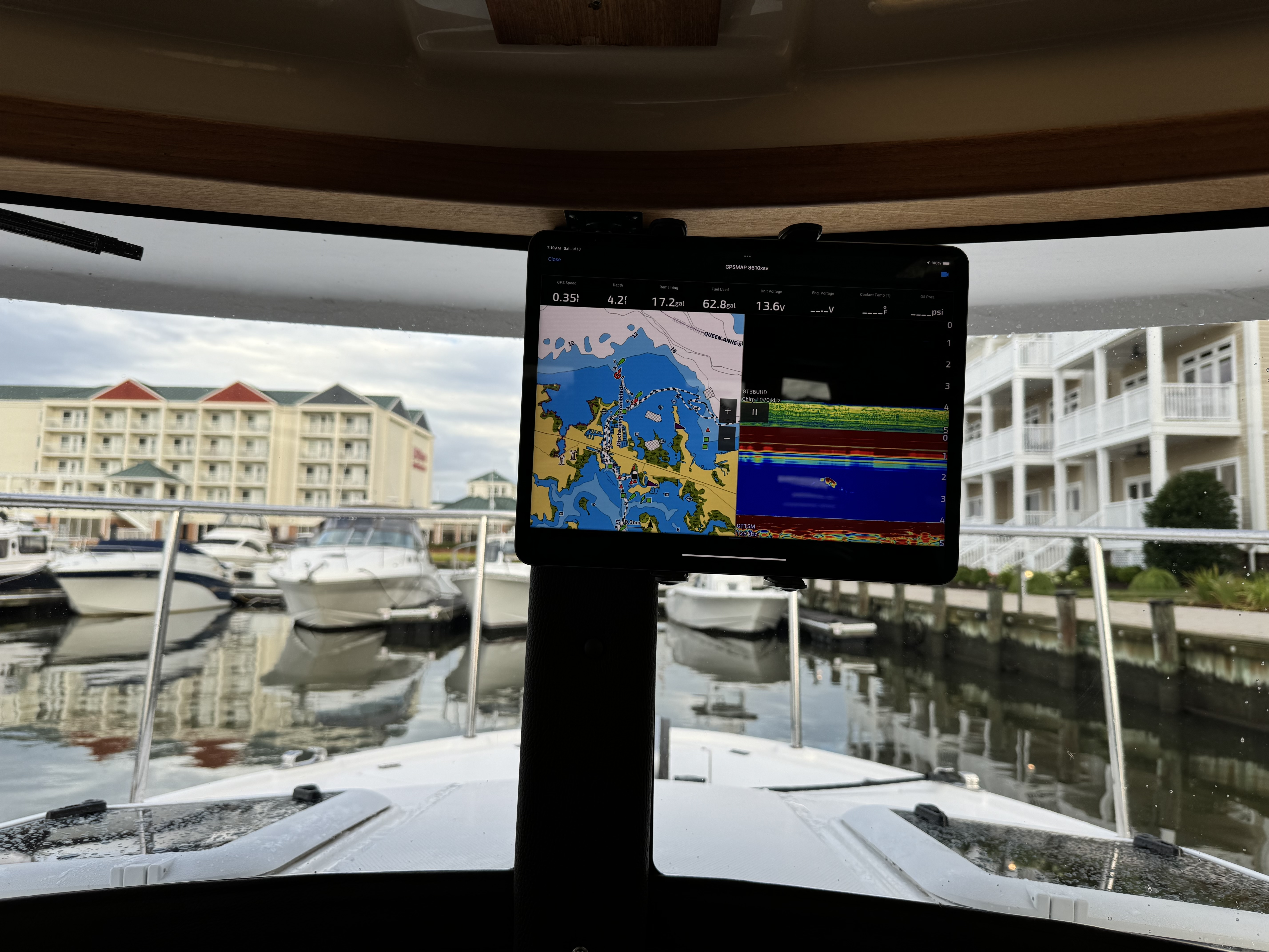

Yes, with 960ah you will need the 120 amp charger. I just use a ipad pro 12" to display VRM when needed. I use it for multiple displays including chartplotter, internet, tv and Sionyx Nightwave Camera
Yes, with 960ah you will need the 120 amp charger. I just use a ipad pro 12" to display VRM when needed. I use it for multiple displays including chartplotter, internet, tv and Sionyx Nightwave CameraView attachment 24505
you could also (if you had a can to nmea) pipe right into the garmin. Another reason I'm using the cerbo
I used to have the 8610xsv wired directly to the Cerbo, I just wasn't happy with the display on the Garmin MFD. I am really impressed with the new VRM Dashboard

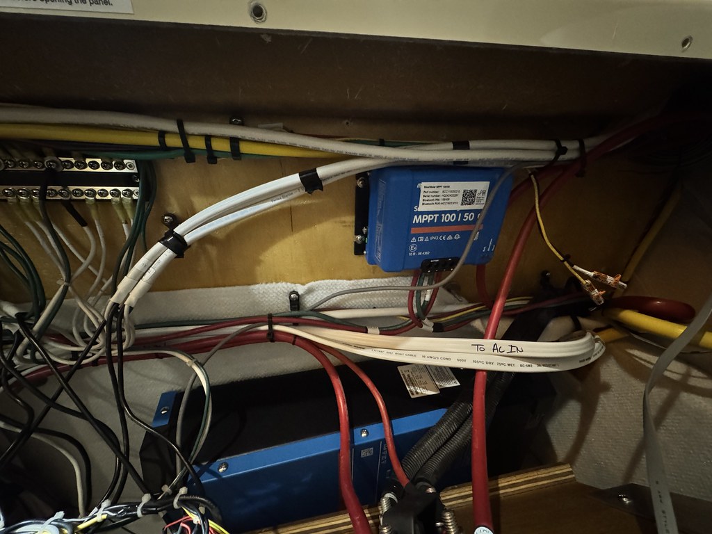

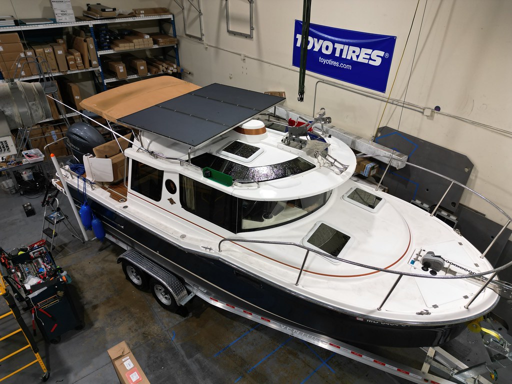

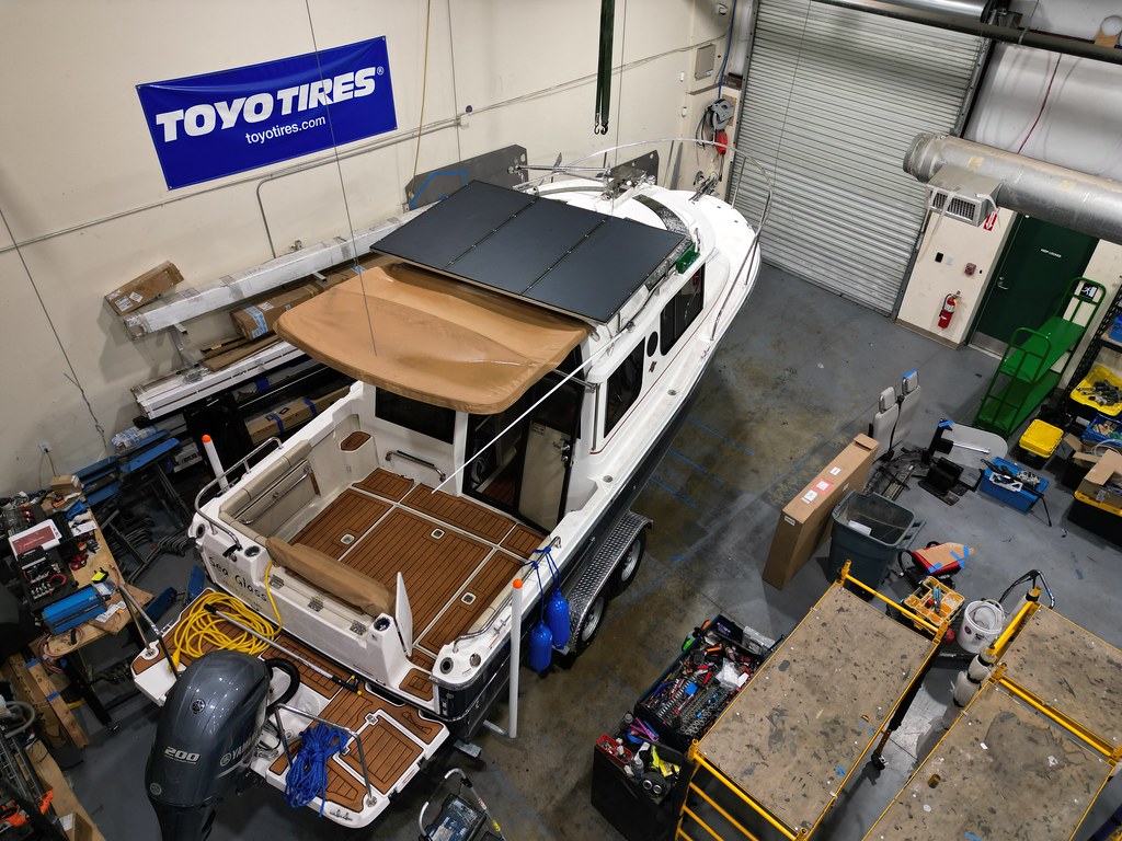

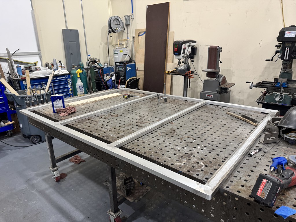

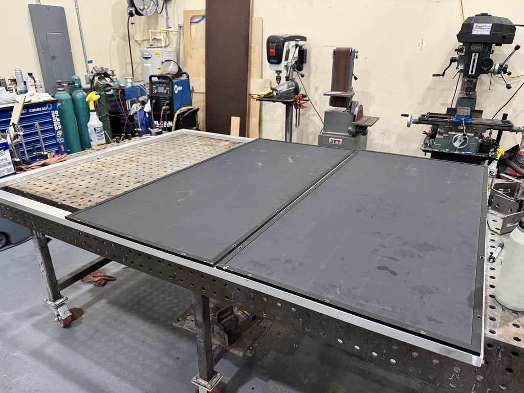

I’m currently working on videos to track progress, but for this post, let’s focus on solar energy and my vision for its future!
Living in Florida and wanting to run the air conditioning unit during the summer, I aim to generate as much power as possible at any given time. With that in mind, solar energy is a key solution. I currently have 1,000 watts on one of my vans and 1,200 watts on the other. With this setup, I can run the air conditioning almost entirely on a sunny day, and at the very least, significantly supplement it on non-summer days. Every little bit helps keep me off the shore plug!
I’ve designed and built a proof-of-concept rack to house three 200W panels for testing. These are SunPower panels, custom-built for robots on a honeycomb structure to be extremely lightweight, weighing less than 10 lbs each. The rack itself is relatively simple, using standard solar brackets for mounting and not intended to be permanent. I opted for this design to install the panels practically and test real-world issues, like moving them to the bow. Overall, I’m very pleased with the results. This weekend, I plan to finish the new rack, which will hold six of these 200W panels, extending over the rear bimini with two support bars connecting to the transom handholds. I hope to install it next week.
I’ve decided to run each 600W array into a Victron 100/50 controller to minimize shading issues. This will also allow flexibility if I want to use suction mounts (seasuckers) to place a bike or other equipment on the rack without compromising the solar system’s performance. Additionally, there will be an option to use only 600W of solar on the rack, freeing up space above the bimini for storage lockers or similar uses. Maximizing the available space above the boat is a priority for me.
Lastly, I ran new 6 AWG wire from the panels to the solar controller, which is mounted behind the electrical panel where the old inverter was located. There’s enough room for both the solar controller and the inverter!
Without further blah blah here are the pics 🙂
