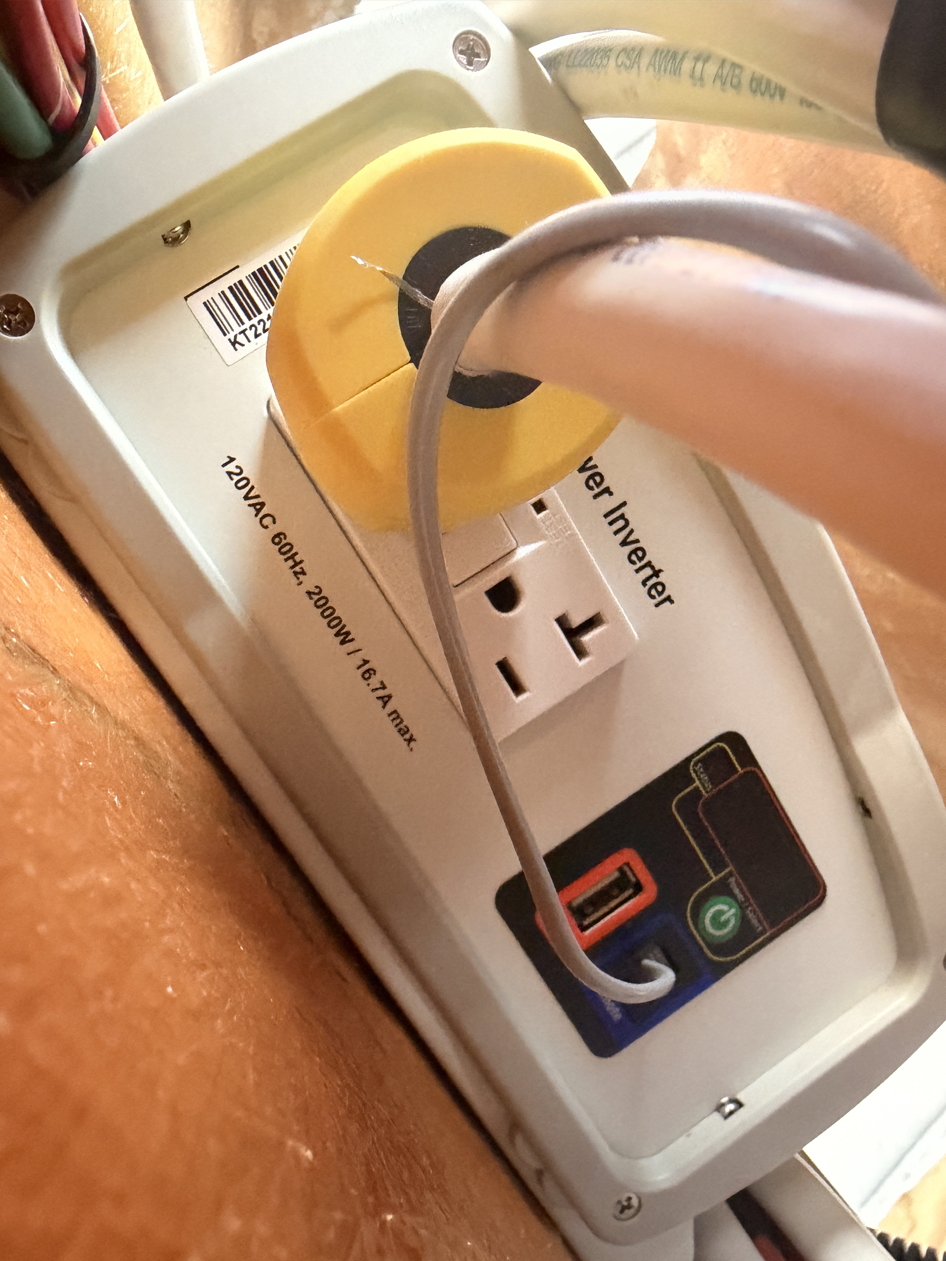

What specific inverter model is used on the 2024 R25? I’ve got these pics but am hoping there’s a general standard instead of having to remove or from the wall.
Pretty sure it’s a Kisae. I’d guess SW1210 but I don’t know for sure.
Thanks Jesper. It’s definitely a KISAE just trying to find out out if it’s the CSW2012 or if it’s the CSW2012-X. I’m working on a LiFepo4 upgrade and am hoping to not having to take her entire inverter off the wall if possible
I love Gemini AI. By plugging all the info in your picture and your boat, it came back with the following: On 2024 Ranger Tugs (including the R-25), the standard OEM factory configuration is the CSW2012-X (2000W / 12V pure sine wave inverter with integrated 30A automatic transfer switch).

What specific inverter model is used on the 2024 R25? I’ve got these pics but am hoping there’s a general standard instead of having to remove or from the wall.View attachment 27889
Kisae SW1220. True sine wave, 20 amps. 2000 watts.
Same one that’s on my boat
