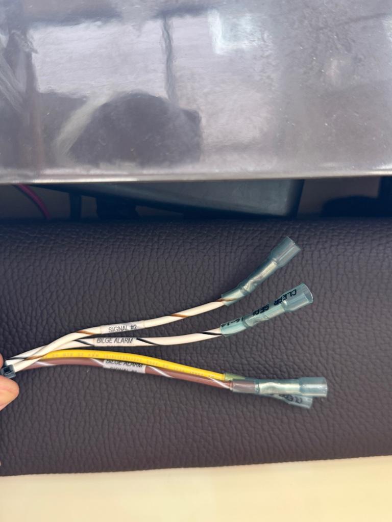

Similar experiences with my 2020 R-27. Am just now installing the missing bilge high water alarm. Do you know where the pick up for the existing wiring is? I can see it coming from the quarter berth fuse block but can’t find it in the helm.
And where did you install the sensor?
Thanks!!
I pulled new wires, from the fuse block to the bilge. And up to the helm. I mounted the sensor on the side of one of my strainers.. still haven't drilled the hole for the monitor head, but planning to put it on the side under the throttle binacle

Thanks! I found where the wiring harness ends for the bilge alarm—it was tucked under the throttle. Glad to have an easy power and neutral for the panel. Still gotta figure out where the signal wires end up!
Can you provide some guidance on where under the throttle you found the bilge alarm wiring? I poked around and wasn't able to locate. Right under throttle, or radio? Any guidance would be appreciated.
Was away from the boat… From your other post it sounds like you found the wiring— indeed under the radio. I’m still looking for where the brown and white sensor wires terminate. As far as I can tell they are not in the wire loom running starboard aft. I’ll let you know if I find them!
