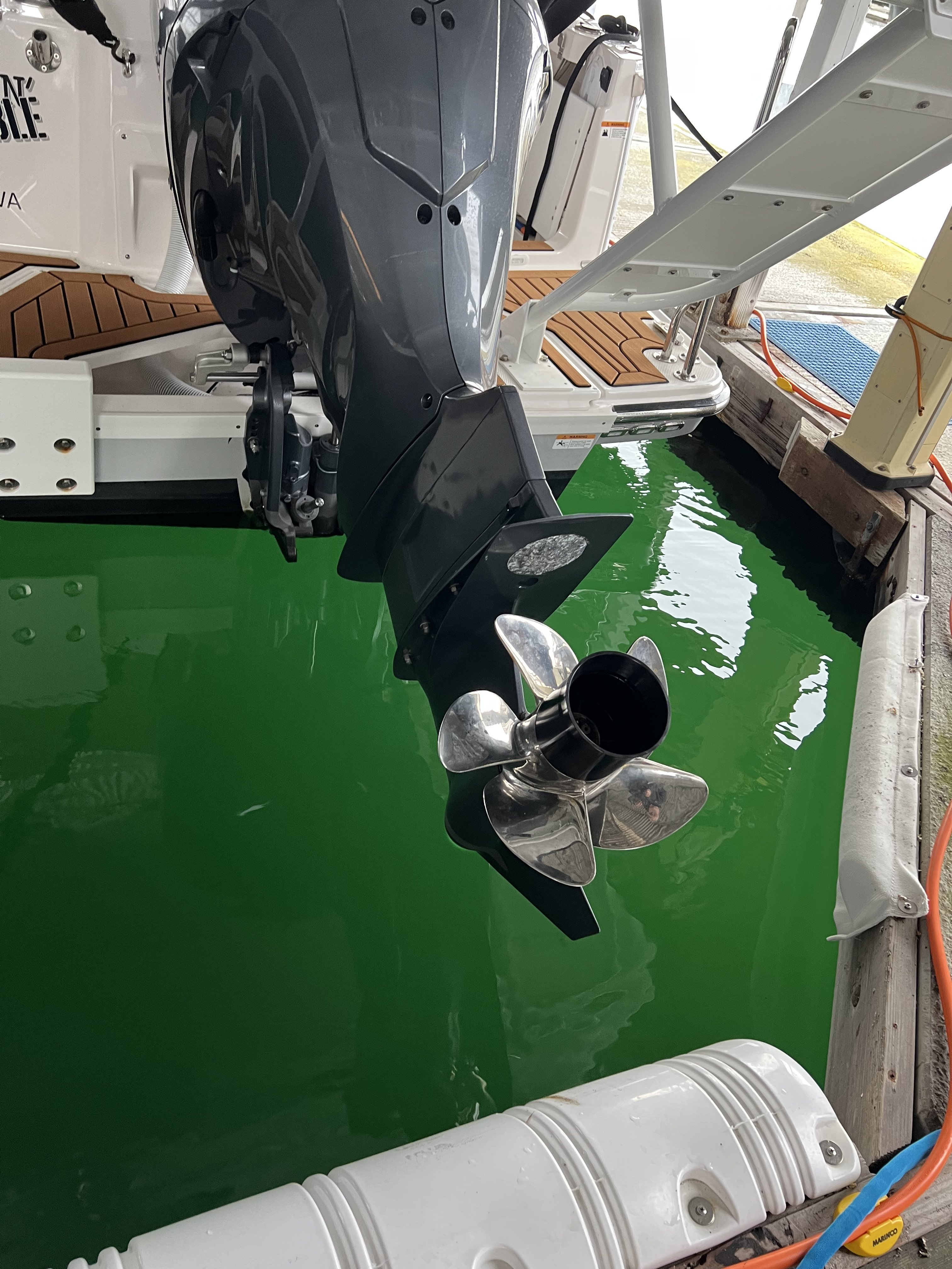

A friend of mine with his brand new 2025 R27-OB LE, with the dinghy lift and less than 20 hours on the engine... SCE5 Modified, Channel Surfing edition. He ran the boat from Everett to Oak Harbor yesterday. Wasn't great weather, but wasn't bad. What you might expect for March in the Pacific Northwest. He txted me a photo of his dashboard/chartplotter. 62.3 miles on 36.0 gallons of gas. 1.73mpg averaged for the trip. He rode mostly at 30mph. His exhaust tube didn't fall off this time. 😀
We used a lot of loctite, and let the prop sit out of the water for several days to ensure the loctite had time to set.
Also, I swapped out his prop by simply backing the boat into the dock as pictured.

If you have the prop, put it together today using loctite. Then install it onto the boat in months. It doesn't need to be assembled on the boat. (i.e. put the exhaust extension on, and the 1" diffuser). Then when you get to the boat in a few months, just swap the prop on the boat.
I lost the first prototype as it was assembled without any loctite at all. A friend of mine lost his, he didn't use as much loctite as he saw me use when I put his second one together for him. He also didn't go around and re-tighten them after initially assembly. So yes, if it's not put together tight with loctite, the extension tube can fall off. The prop isn't gonna fall off the boat, and the prop will get you home fine without the exhaust tube. The tube extension improves fuel efficiency and stern lift between 3,000 and 4,000 RPM. above 4,000 RPM, the prop works the same as without it. The exhaust extensions are inexpensive.
