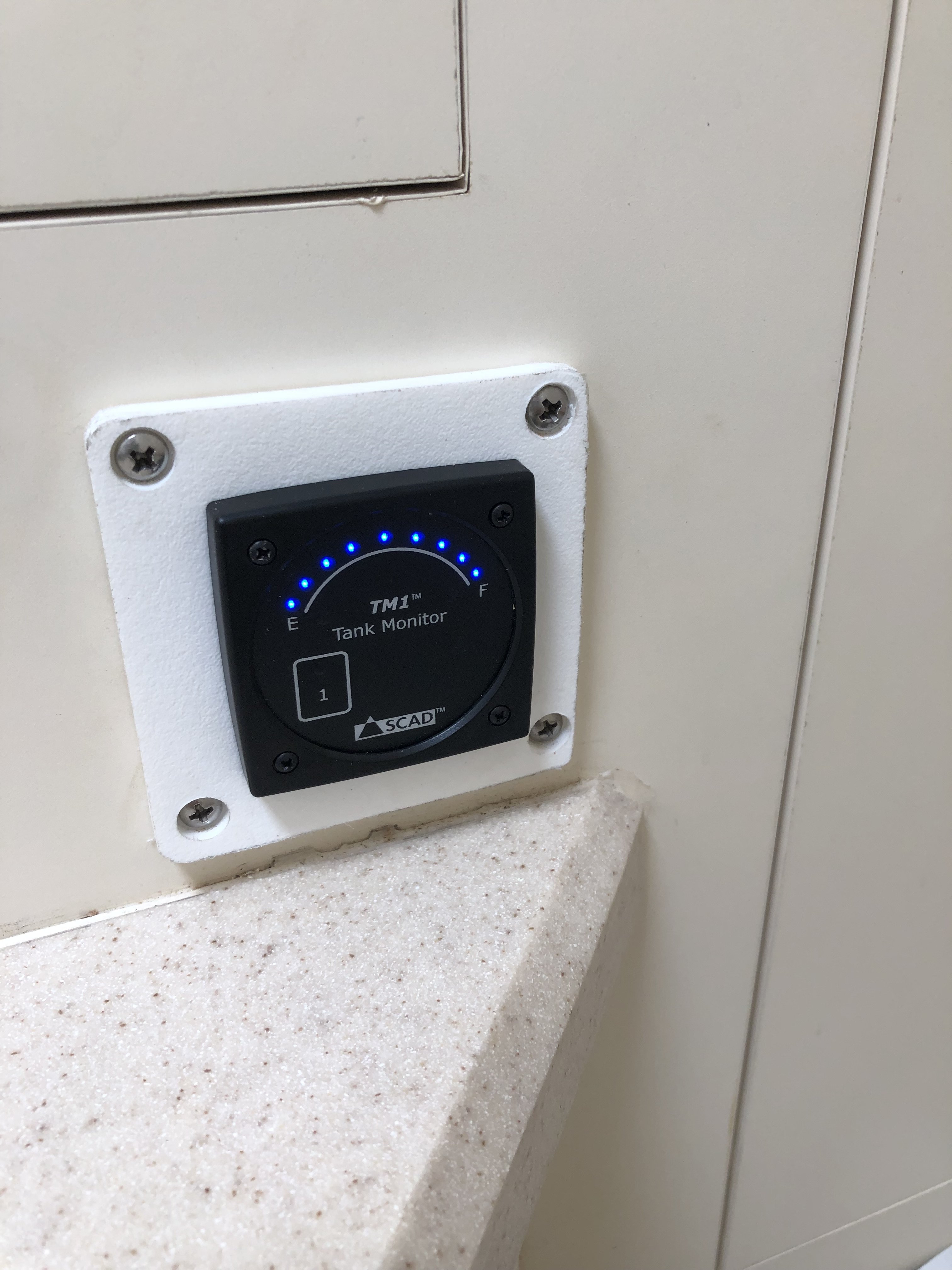

I just installed the SCAD monitor for my holding tank, the existing Tecma sensors always report green on my tank.
I just calibrated the tank last night during a pump out and now it's successfully reports full and empty, and while pumping another full tank of water out, it goes down smoothly on the 10 LEDs every few seconds. Perfect
It only took 3 hours to install, most of the time spend was pushing the wire from the tank to the toilet location, I ended up needed to remove the tank holds and slide the tank forward to re-plumb the snake, if I did this from the start it would have been even faster. I tapped into the 12V from the cigarette socket in the berth that is right behind (which has been replaced with a couple of USB only plugs)

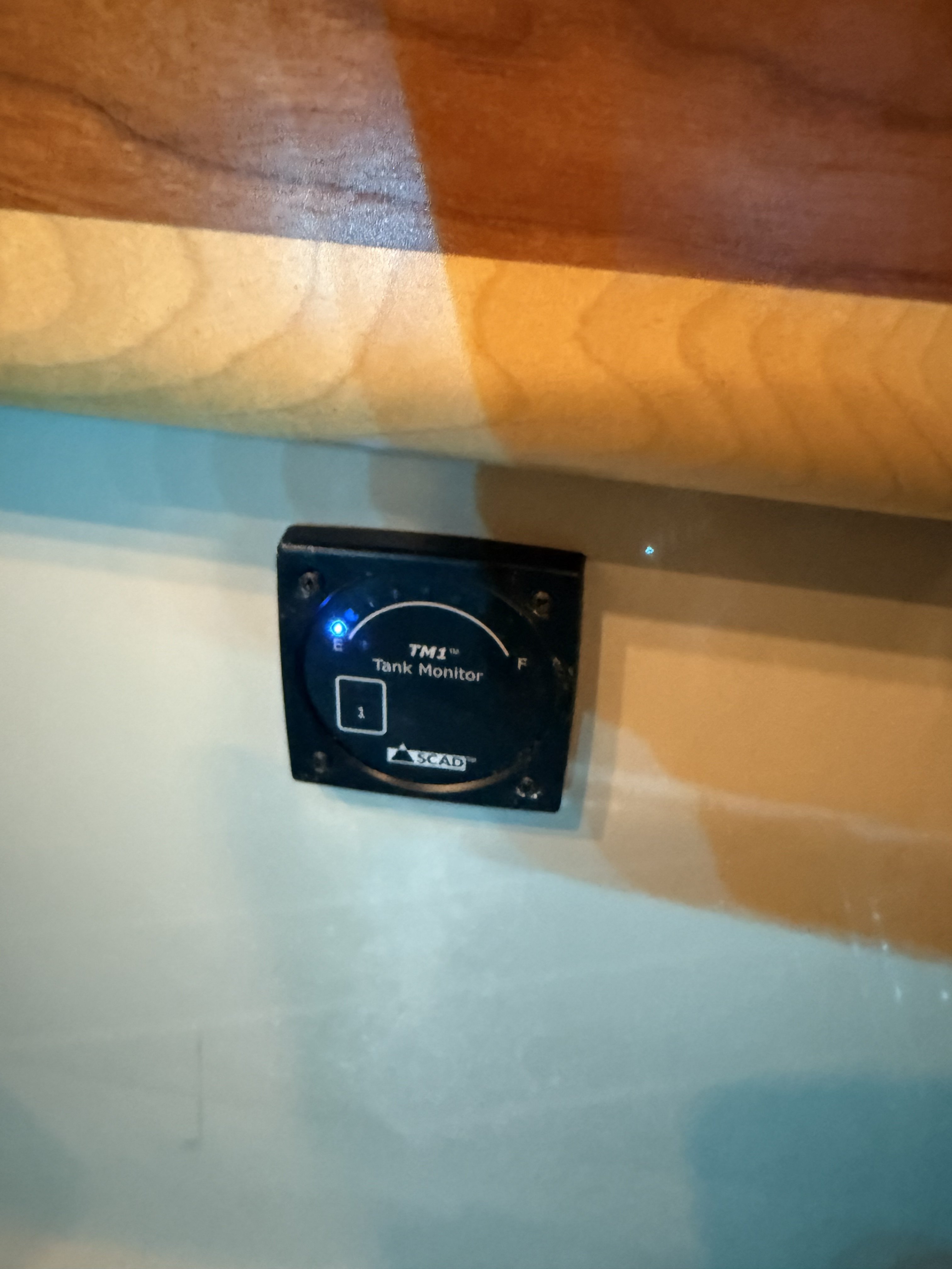

Here is my Scad I mounted on my CB 30
Scad monitor as stated above, is not terribly hard to install, it’s the calibration that takes time and patience. In theory, it should only take 15 minutes, I’ve installed 3 now, and each one has its own nuances. Read and follow the manual on calibration exactly! I pre wrote down all the settings and as it goes thru each step of calibration, I’m not fumbling for the correct button push. Once you get it working properly, ifs fantastic!
I did the calibration with the boat on a trailer in my yard. I filled the black water tank probably three times with a garden hose and used the Macerator to pump out in yard. I took probably three hours to calibrate and verify. I think it would be impossible to be sure the calibration was correct any other way. I also checked to see factory stock red yellow green lights at same time. The red light never came on. Yellow light at 40% black water full. That varies on each boat since I doubt factory sticks gauge on the exact same place on each tank
Sounds about right, but mine lives in the water year round. I calibrated at the pump out dock. Filled and emptied about 3 times as well. If you make a mistake you pretty much have to start all over, thus the learning curve on the calibration process.
