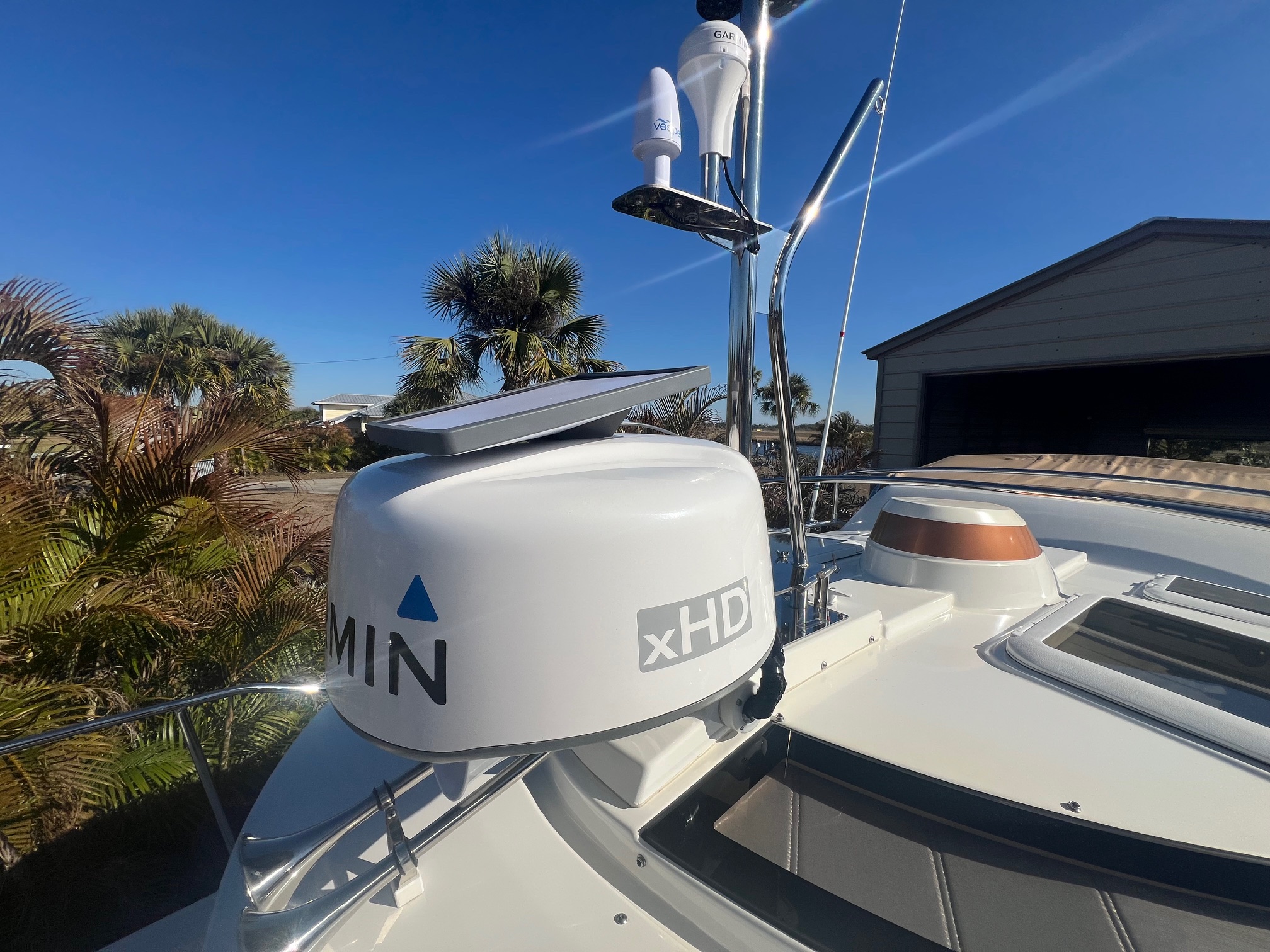

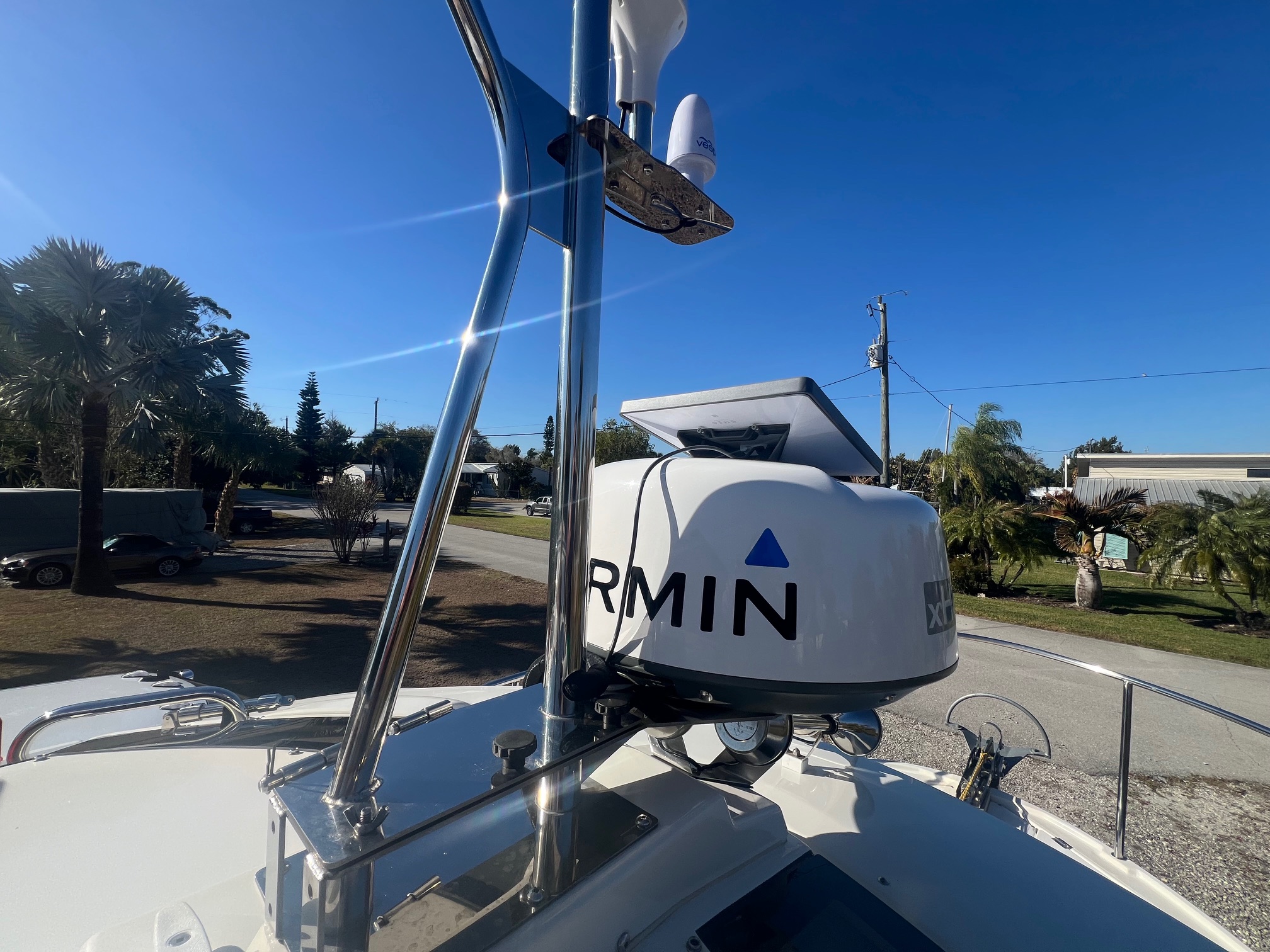

We mounted our Starlink Mini on top of our radar dome using more or less the same techniques that Leo outlines in his video.

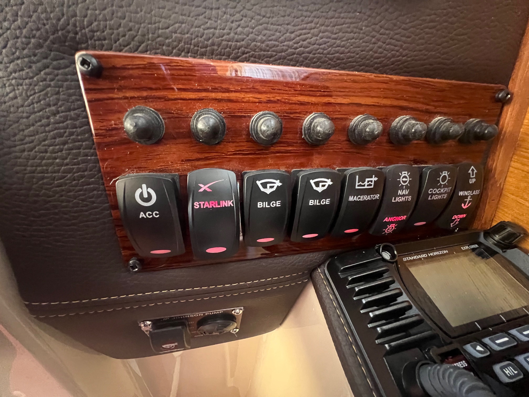

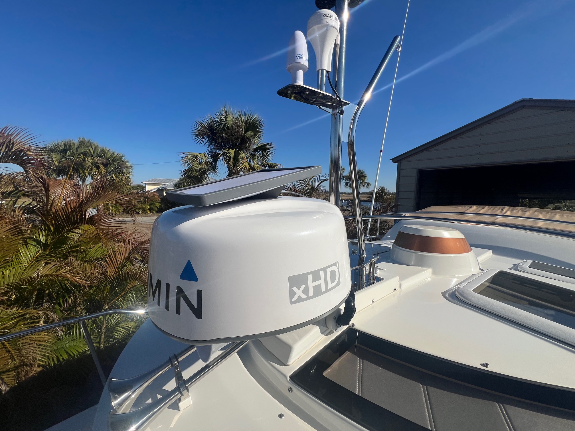

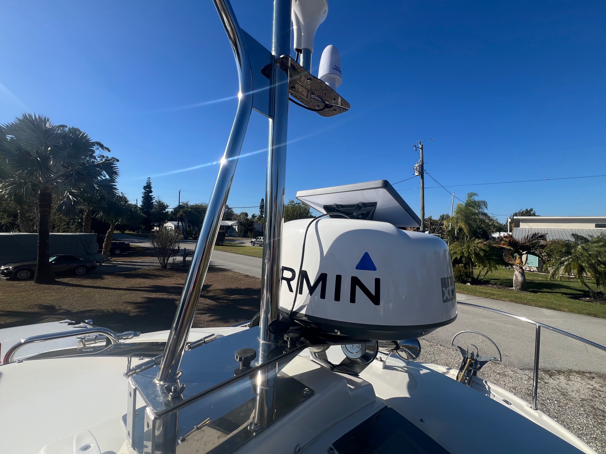

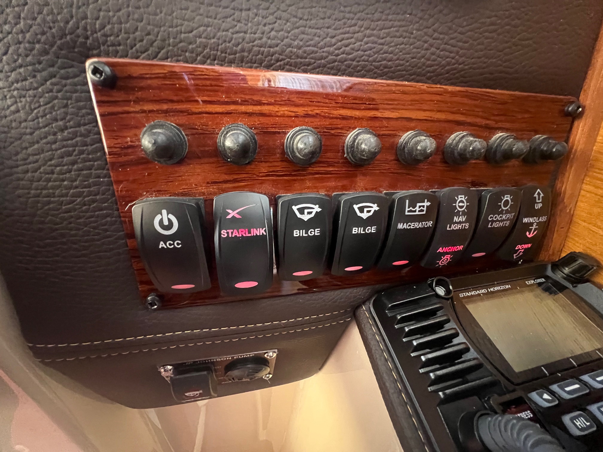

Similar to Leo, we have found this location to be ideal. No interference from the radar in our internet connection and no interference from the internet connection on our radar. We hardwired a 30v DC power supply and switched it on the panel with a custom rocker switch like Tristen T.
