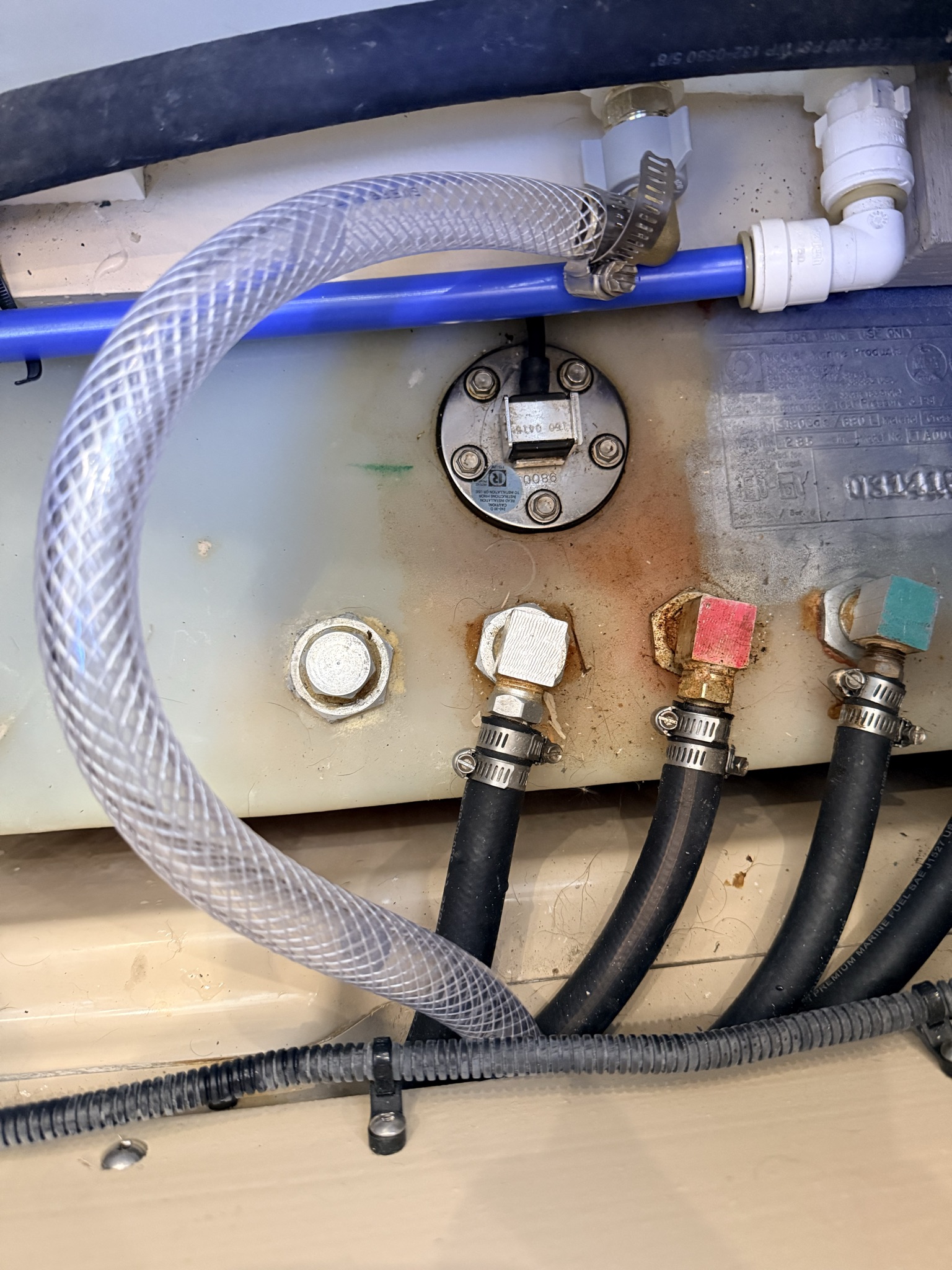

You might consider T-ing off your freshwater line under the sink to a short dead-end hose fitting that you could connect a hose to and sacrafice a tank of water after every use? A freshwater washdown/shower at the swim platform is something I think would be a nice option on these boats.

I have pondered bringing a long hose out there but haven’t tried that yet. I’ll let you know if that works. Your idea of T-ing off the fresh water line is also interesting. I wonder how many minutes a full water tank would last under that method. Not sure how many gallons per minute would flow through the engine with the ships pump but it’s worth a try and boy would that be slick ! And even if I could only get five minutes that would probably be better than nothing right?
